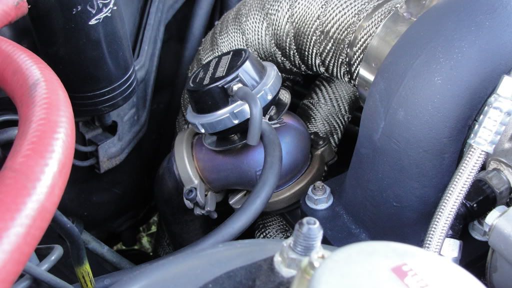

So here's what I've experienced in the wastegate department:
Stock turbos with stock internal wastegates work pretty well in stock form, with stock boost. Once you start to push the boost up, you gain power but your exhaust is holding you back. Once you upgrade the exhaust, the stock internal wastegate usually can't keep up and you get boost creep.
Aftermarket internal wastegates are a similar situation, even when they are designed to work with bigger exhaust, I've always experienced creep (even with my BOSS Sr.)
In my opinion, once you start to run higher boost on a bigger turbo (usually aftermarket) external is the way to go. I am personally using a TurboSmart Hypergate 45mm V-band wastegate and have been very happy with it. While I do creep when I'm trying to keep the boost low (~4-6psi creep by redline) it does beautifully when I really let the engine have the beans. Everything above 20psi is golden all the way up to the current maximum boost of 31lbs. All of this has been done on a 14 pound spring set, which I'm very happy about.
As for venting, I am currently running a screamer since it was the simplest to set up, although once I get the new 3.5" downpipe made, it will be recirculated.
Here's the only picture I have of it, shows that it's pretty toasty when it's operating!
It sure does look nice and pretty in there. Nice and snug too like it belongs in there.
and that's true too, definitely don't want any, or at least have minimal creeping issues.
Routing it to the Dp is obviously the best chouce for me. It's now just become a curiosity for me as to see if any aftermarket turbo companies offer internals.
