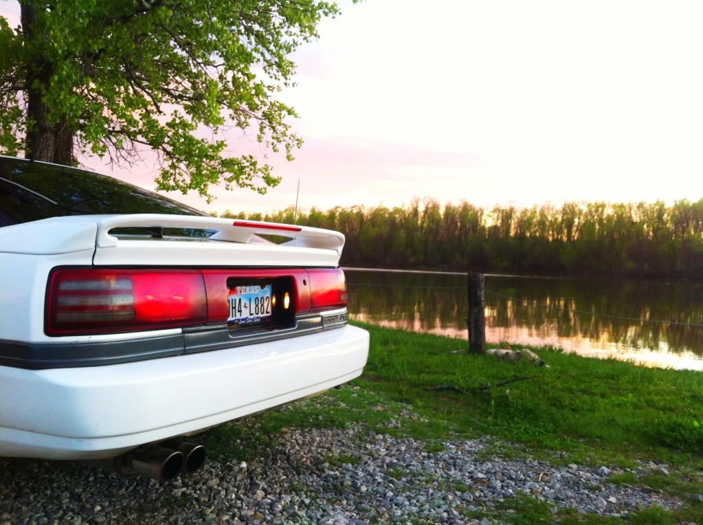

I am running a Vibrant dual tip 3" muffler and reasonator on my 89. No drone. It's aggressive sounding but quiet while cruising. No FART CAN sound!
