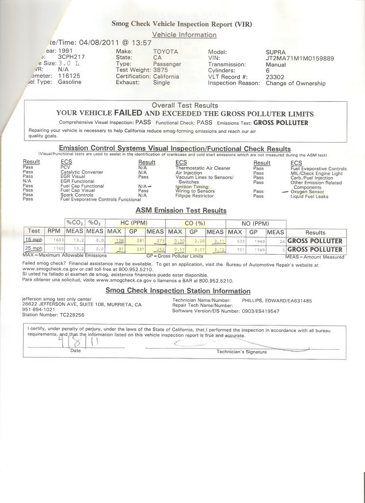

Any ideas.... the technician said timing... I really smell the fuel also.... Really dont know how to adjust timing on 7m-gte's....

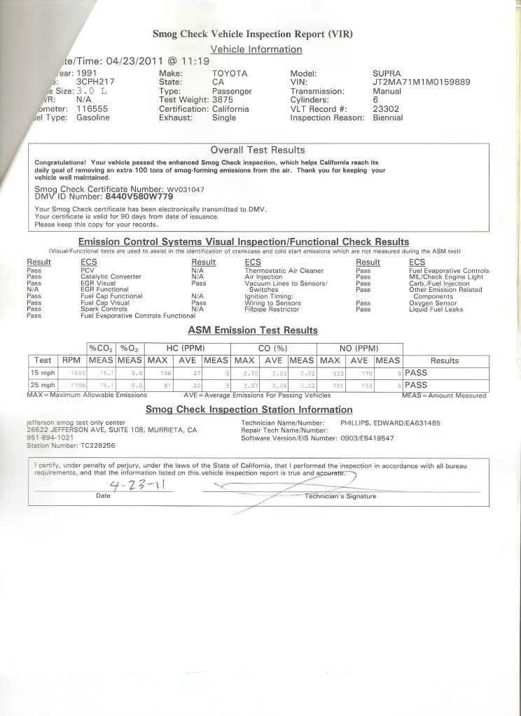

I was surprised on how much an O2 sensor could change the smog. No more scent of gasoline.. Thanks for everybody's input..

Adjusting timing will not solve this issue.
The technician is a bonehead, timing is to be checked by the technician, on all cars where timing is adjustable.
As to solving the issue, the car is not in fuel control. Pulling codes would be a start. Whats the O2 voltage?

It is kind of odd timing wasn't checked since that's part of the test protocol. Agree with chip though, definitely not in fuel control.
I notice this car has a 100% pass history all the way back to '97 including the last two times at the same station in Chula Vista. Curious as to why this is a change of ownership test...

Pulling codes would only be relevant if the check engine light were on. It's worth him CHECKING the timing at the very least.
Not all codes turn the CEL on. It's worth a shot to see if it has any saved codes.
Agreed on the tech being a bonehead (hell, I always have to show them how to get the ignition probe on my car)

Back in 2007 and 2009, the car had a good smog report. The test was done in chulavista CA. Ive been smelling fuel before but I had an exhaust leak on the exhaust manifold at that time... I took it to kaizan to get it fixed for good cause they had to put new threads on the block. kaizen did a good job and fixed it...
But nowI moved to murrieta and I had to find another smog test only station... I was expecting failure. The technician told me that he could not check the timing because the spark plugwires were covered. I just wondered how they checked it before...
As for the O2 sensors, I have no idea, not yet... How many does it have?

Next time tell him to check it using #6. The car has one O2 sensor. Btw, had you installed one of those "useless" light show displays you'd have known exactly when this happened and could have gotten right on it...
