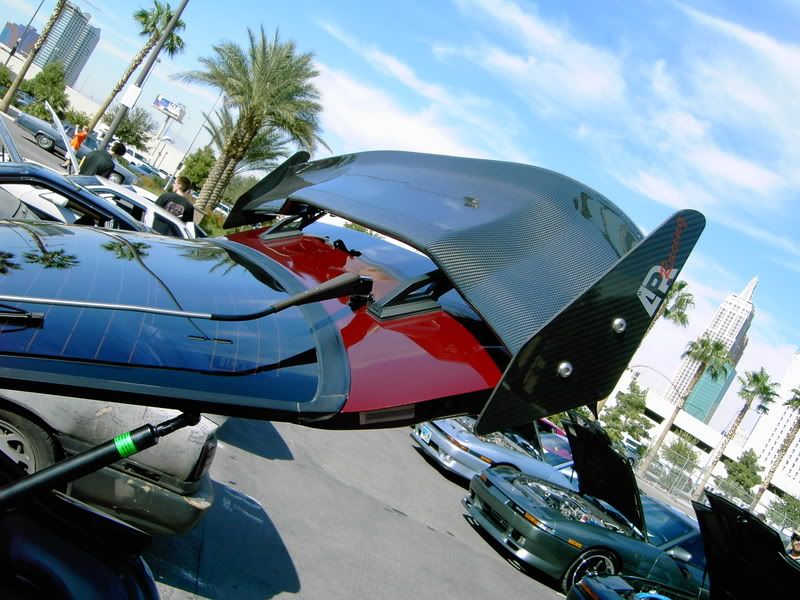

The only addition that might look "modified" is a wing that extends the rear hatch.. a trick to not only lower drag, but also create even more low pressure behind the car, that the rear diffuser can then direct air into, enhancing downforce and lowering drag.

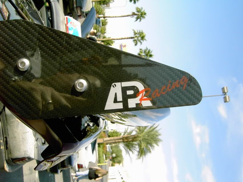

A wing positioned like this would actually do that. (Hope the owner does not mind, but I saw this years ago at SILV, and liked it so much, I photographed it, and might someday copy it with some slight changes...)
Here you can see how the wing hangs back, over the end of the hatch.
