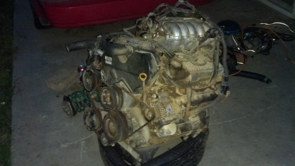

Got the motor to my house today. Probably won't have the time to work on it much till Monday. If I get time ill unbolt my r154 from the bellhousing to see how well, if at all, the bellhousing bolts up. If it does we move right along to fabing mounts, if it doesn't work then I have to find the 5 speed bellhousing from a hilux. I have no idea if there's a difference in the hilux bellhousing vs the us equivalent which I am under the impression is a tacoma. Ill be ordering megasquirt in 2 weeks and using a gm 3bar map sensor. Will be getting it running decent na before I get to boosting it. I haven't settled on a fuel pump yet so anyone with some ideas should chime in. Here's a few pictures of the motor as it sits
http://i1076.photobucket.com/albums/w455/xxxpg13/2012-06-21_20-22-42_215.jpg
http://i1076.photobucket.com/albums/w455/xxxpg13/2012-06-21_20-22-53_817.jpg

http://i1076.photobucket.com/albums/w455/xxxpg13/2012-04-30_10-53-20_851.jpg
Stay tuned, much more to come…
