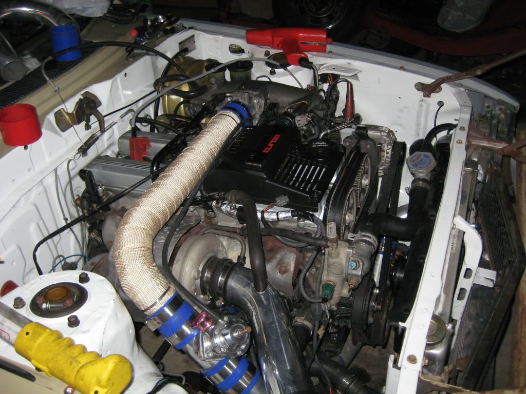

Some background info:
I have a 1977 Toyota Celica that I swapped a 92 turbo supra engine and R154 manual transmission into.
Rear axle is out of a '68 big block Dart, a 8.75" with a 3.91 gear.
I built myself a Megasquirt system for the car, all assembly and tuning is and will be done by my lonesome.
Currently I only have a rough tune, about 1 hour into making the volumetric efficiency map, and I just made an educated guess on timing, because I was running out of dyno time and I just wanted to make some shakedown runs at Milan.
Well, I ran a 11.51 @ 122mph, not too bad for not being tuned yet! It should have a lot left in it once I get the tune all set, and up the boost some more. It is set up for 2 step launch control, but I didn't use it on these runs. Running around 16psi right now, and I plan on 20+ once I get the roll cage in. So it will be somewhere in the 10 second range. (and 30+MPG, I just thought i'd throw that in there :naughty1: )
Well, at the strip, I ended up breaking the Mopar differential, which is the last thing I thought I would break!
It is a cone style limited slip, and I busted off one tooth off of the one side gear, luckily I was still able to drive it home!
This is pretty much a strictly street car, but I do like to take it to Milan once or twice a year.

some pics of what I have:
