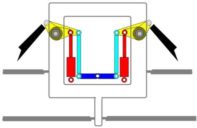

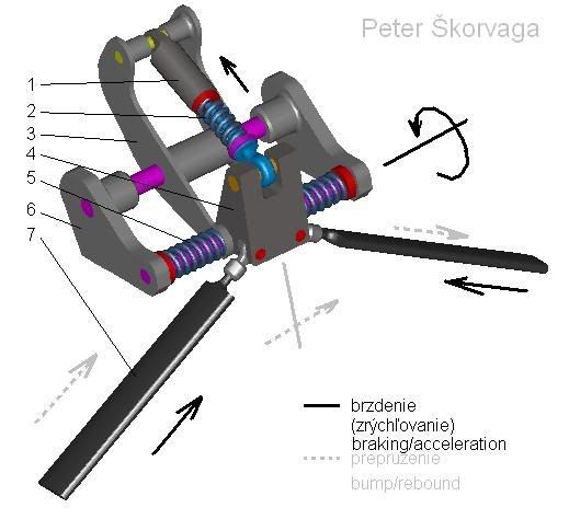

Thanks Hommer, those diagrams answer my questions regarding the "lay down" shock set-up we were pm'ing about.
I see most of that type of set-up would have to be fabbed, but I wonder if the pieces that link the coilovers to the actuator arms (or whatever you'd call them) are somethinig that could be easily bought? I don't recall seeing suspension hardware like that, but I've never looked for them, so I don't know. Might be cost prohibitive but I love the F1 idea.

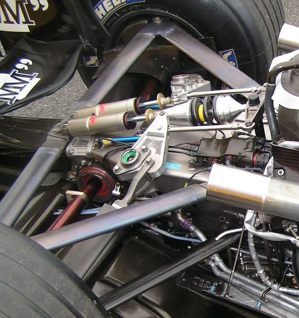

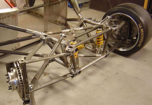

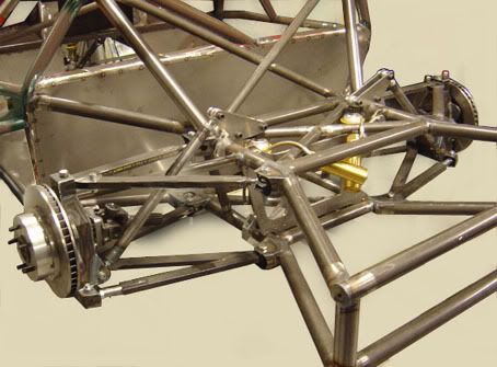

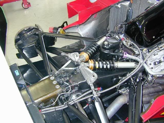

HommerSimpson
Dec 31, 2007
1,067
New Smyrna Beach Florida
I believe the design or the moving parts or what ever is called.. Pushrod rocker suspension.. i think its doable with out choping car up alot...but is not going to be something that will be easy..
What i would do.. if you have time... get the wheel tire combo you want to put on.. if you cant find a loner or something make one out of cardboard and gorilla glue.. :} just make it close to the size of tire you want under...
snatch the strut and front trailing arm off and stick it on there.. see were you are at...
maybe ditch the front trailing arm all together.. and add one to rear like the middle one.. at a angle.. / | \ < like that :} lol
figured easyer to post then to PM...
hope you decide to do something.. :}
