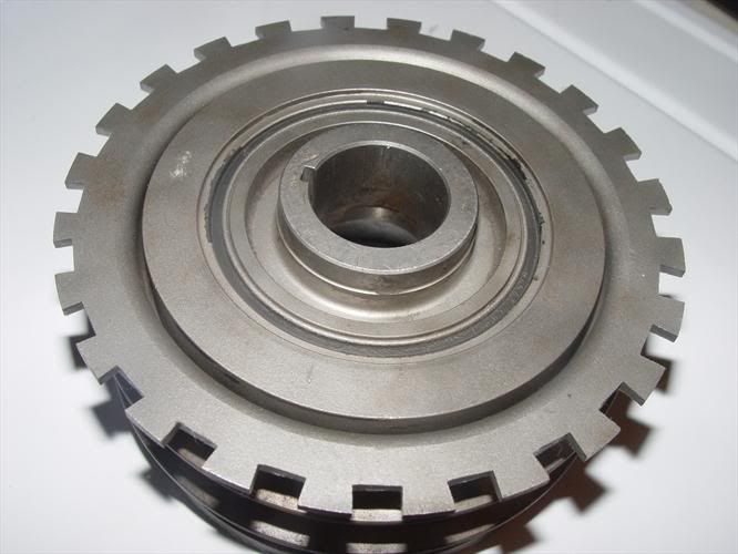

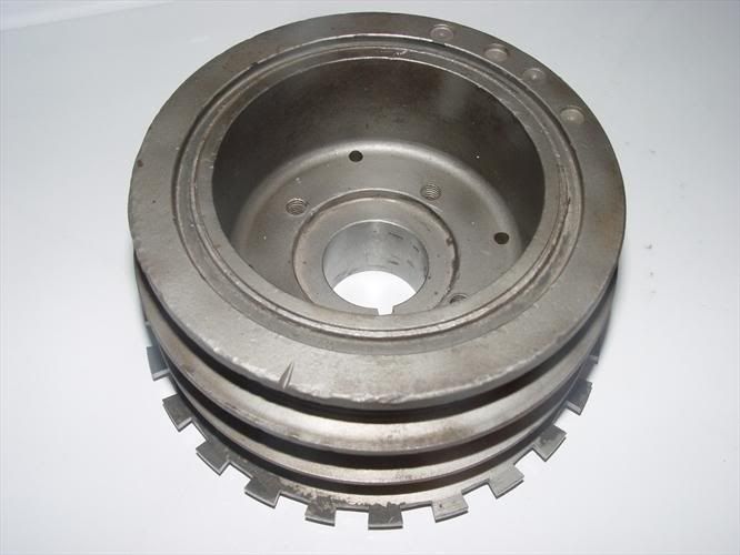

stevenr816;1666800 said:
Is that machined down for a press fit? Can't tell if it sits on the very top or slides on.
What are you using for a cam?
I actually just machined it directly into the back side of a stock pulley, I never finished setting it up on my 7M as the cps ended up fitting without issue with the turbo I used.

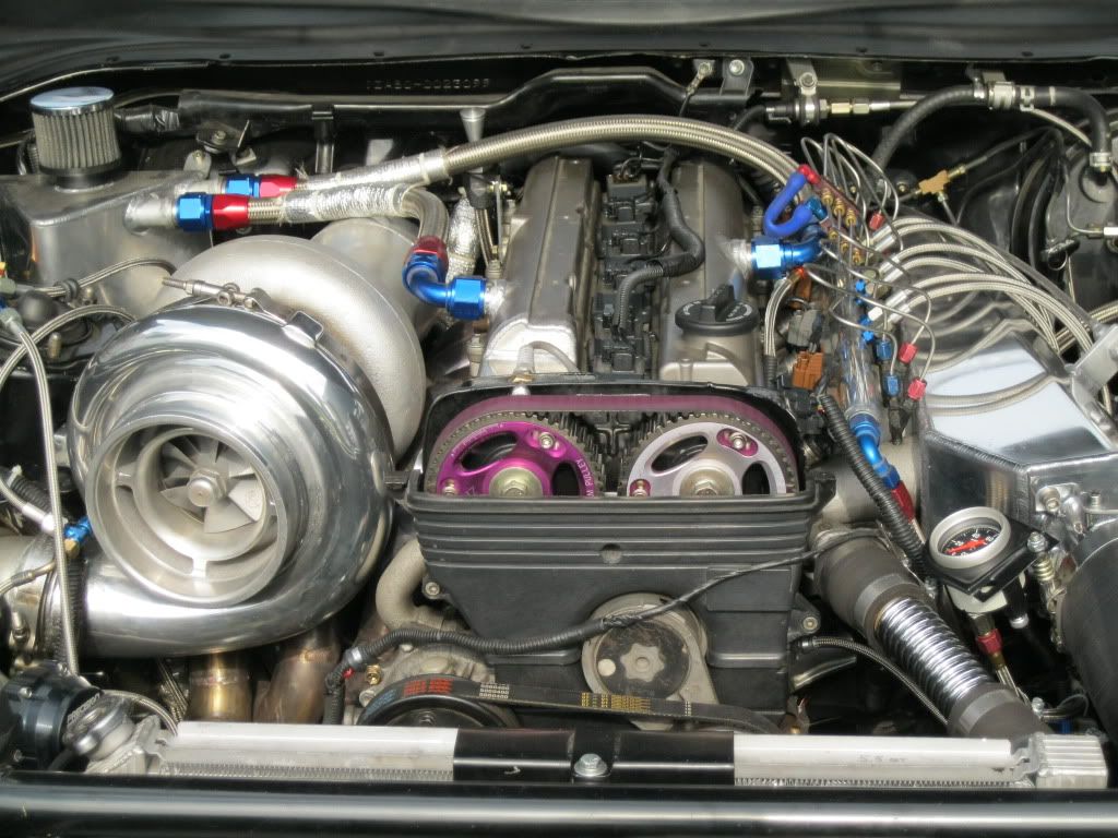

A friend of mine just put a sensor and a magnet onto the cam pulley as seen here, so the same should work for what you want.

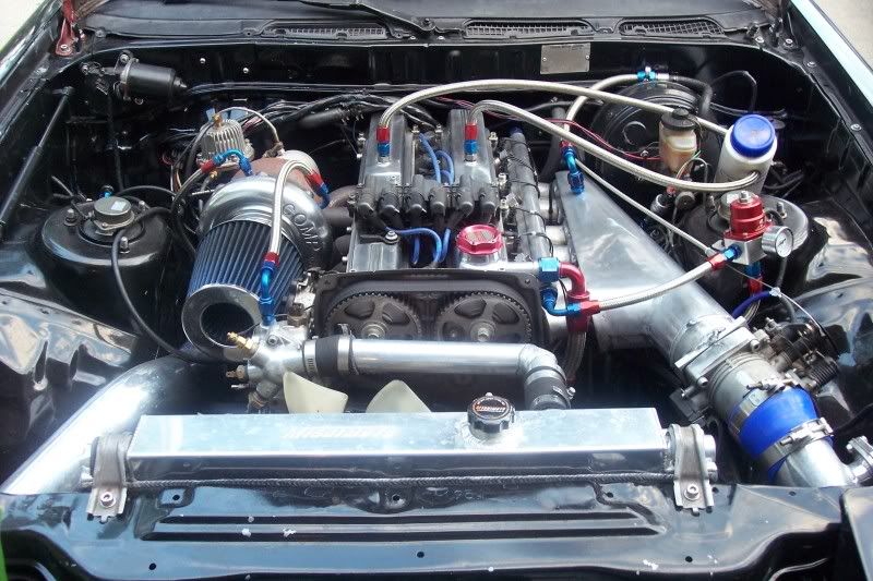

I was running a custom built comp turbo. 74MM TBB aluminum center section and a .81 ar exhaust housing, with an mx trim wheel. Here is a pic of the old setup.

Looks really good, couple things I would change to make it look better but that's me and I'm a OCD clean freak lol
What plenum is that? I just ordered a 1jz ffim of Driftmotion for 180 and cutting the runners of, making runners to bolt to a 7m flage
