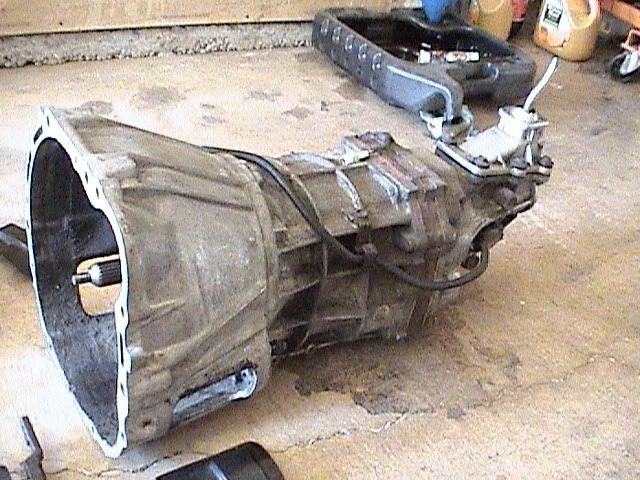

The slave cylinders of those two trannys are far from the same.
Here is an R154. Notice the inspection holes in the side of the bellhousing.

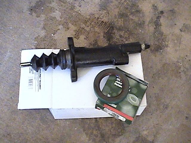

Here's what the slave looks like
Hope this helps.

Minoria_Zelekta said:
thanks guys i think i have tha r154 so ill buy the slave like the one on the pic thanks to all.:icon_bigg
Easiest way to tell the different is if the tranny has an inspection plate it's got an r154. If not... It's a w-58.

BlackMKIII said:
W58 = Push-in clutch
R154 = Pull-out clutch iirc.
Yes? :dunno:
True, just jack up your car and look at the slave cylinder. If it looks like the one in the picture then its a R154, slave cylinder bolts face the from the of the car. If it has a slave cylinder with 2 bolts on the top holding it to the bell housing going towards the passenger side then its a w58.
