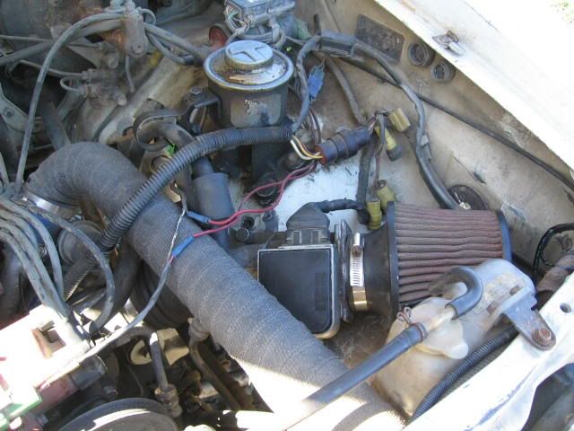

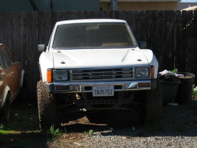

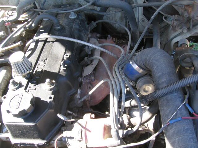

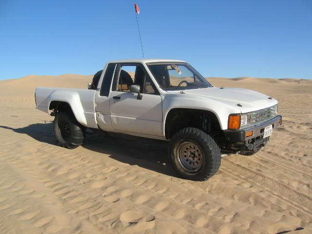

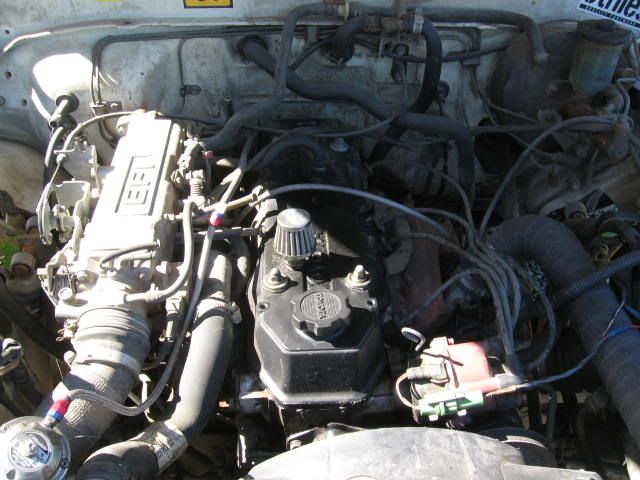

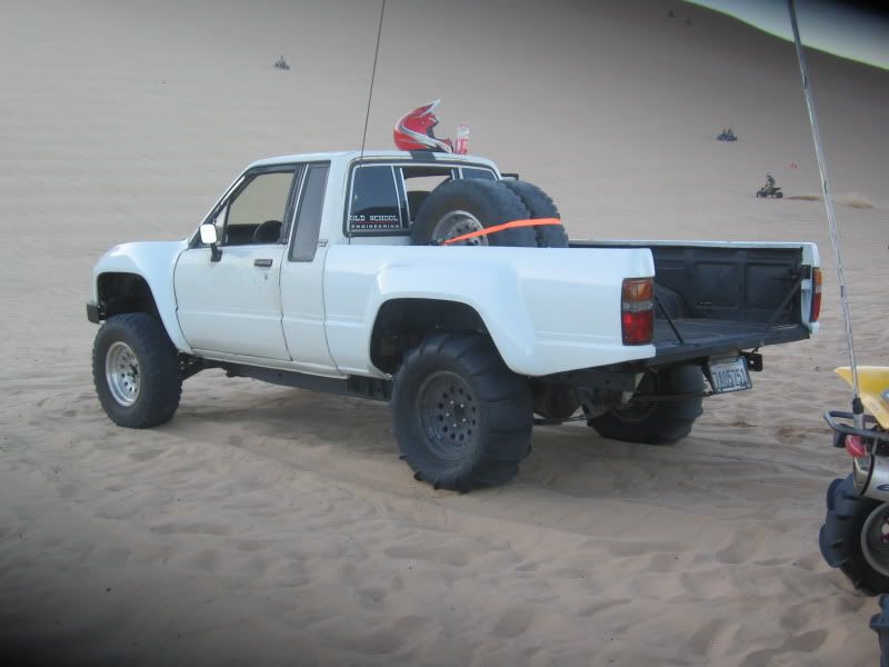

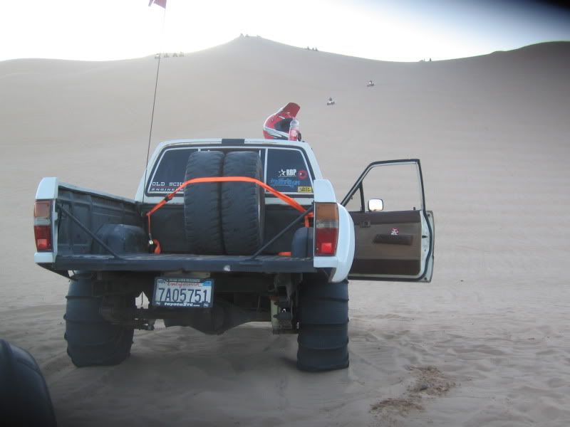

anyone else like toyota pickups
heres some pics of mine

Nice pre runner! :) I'm diggin' the fenders. You on Yotatech? That truck looks vaguely familiar...

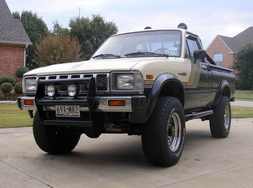

Mine, which will undergo a 9.1:1 CR 7MGE->T swap this summer if I play my cards right. (I've got the parts, but never the time!)
Currently sporting nothing special: Marlin Crawler tubular rear bumper, Detroit/Eaton True-Trac rear diff that'll be going up front when I put an ARB airlocker in back, 31x10.5 BFG MTs, soon to be 33's or 35's after the motor swap, and I'm figuring out in my head how to put a Supra 8" diff in front so I can retain independent front suspension but have a stronger diff and more flex for a better ride both on and off road. I put MKIII Supra seats in it, too. I love this thing and have owned it for a bit over five years. It's the most reliable vehicle I've owned and has never let me down.
How do you like that 22rte?
Why go air locker when the TRD electric locker is a drop in?

E-locker is nearly drop in, I know. I almost had one about a year ago but it was sold before I could pick it up locally. :( They both have their ups and downs. E-locker has a motor sticking off the side of it which can be destroyed if you hit something, or can hang up on you even with a MC e-locker guard on it. The ARB can get the air line ripped out, thus leaving an exposed hole in the top of your diff.
The ARB is stronger, though. Honestly, I bounce back and forth all the time with that decision, so whichever I find first for a good price will be the one I go with LOL.
Air locker doesn't lock if you lose pressure, IIRC the e-locker doesn't. Also, the e-locker is much cheaper as you get the entire third member. Most of the guys I knew that used the ARB only did it becuase they wanted on board air anyway so they could air back up after rock crawling.

True. They also make cable conversion kits for the e-locker. Honestly, I'd pounce on either if I could find one locally. I'm not worried about OBA- I'm going to build a custom bracket to mount a York compressor to the pickup so I can run air tools off it if I want, not to mention airing up.
Wellllll you can get a e-locker from marlin, with lower gearing installed :D

Yeah I know. I just don't know what size tires I'll end up with so I don't want to buy new. With the 7MGTE in there, I'll have all the power I need, and if I get a crawl box I should have more than enough gearing for around my area.

thanks, the motor isnt a real 22rte. i built the motor out of two 22r's that i prevously blew up. block form one, head from the other. the head is a stock na head. i did a cheap rebuild on the block in my garage. new bearings, oil pump, water pump, ebay turbo pistons and rings, timing chain guide, timing chain and cam sprocket. headgasket is a cometic steel off of ebay. stock intake manifold and turbo manifold. nissan 300zx t3 turbo, ebay intercooler,
22rte turbo computer, na supra injectors.
im also using a supra 5 speed tranny because, i blew up the stock truck unit. six puck ebay clutch thats lasting over a year now. my current rear end setup stock welded with 3.90 sumthin gearing. ive already been threw 2 diffs and snapped 1 axle.
the truck runs strong for only 11 pounds of boost. its been running strong now for about 2 years sprisingly. i offrad alot and its been really reliable. real fun on the streets too
