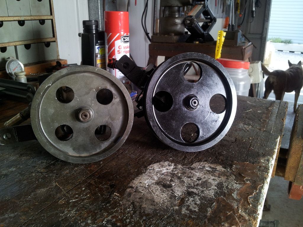

To the best of my knowledge, the only difference between PPS pumps and non-PPS pumps is the drive pulley diameter.
My car is an 89 with PPS, but I have recently replaced the power steering pump with one from an 86 IIRC and steering is fine! I simply swapped pulleys over...
PPS pump on left - 135mm dia. pulley
non-PPS pump on right - 150mm dia. pulley

There are 2 types of pumps, with or without PPS.
1986-88 No cars had PPS
1989-92 All Turbo cars have PPS
1989-92 N/A without Sport Package have no PPS
1989-92 N/A with Sport Package have PPS
If your car is a 1990 turbo, it does have PPS (aka Hydraulically Reactionary Electronic Control).
PPS does NOT necessarily make the pulley different, there are 2 different pulleys used on the Supra, but PPS doesn't always determine which one it has.
1986-89 N/A without PPS and 1986-88 Turbo cars have one type of pulley.
1989 N/A with PPS, 1990-92 N/A with and without PPS and 1989-92 Turbo cars have the other type of pulley, this is completely independent of whether or not the car has PPS.
Either pulley will fit on either type of pump.
