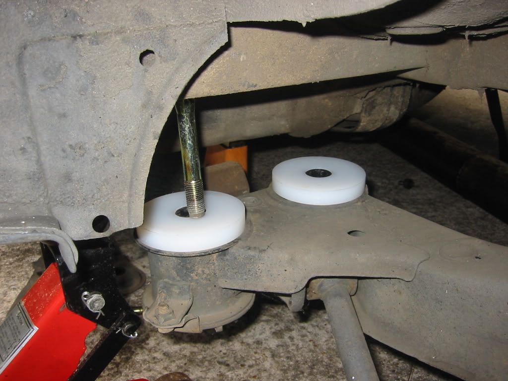

Front mounts:

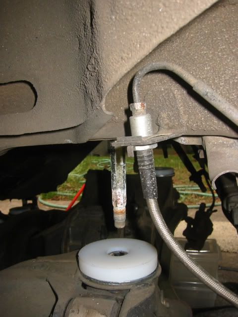

Rear mount:

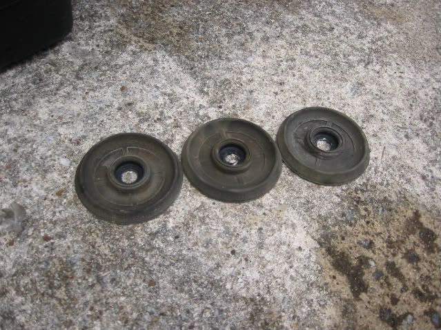

Old spacers:
