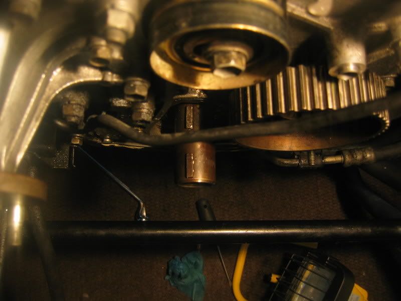

I Have been struggling for the longest time to set base timing to 10" but cannot. i set everything properly cams and crank shaft all at 0 as well as setting the cam position according shaeffs picture but seem to have no luck. when i try to turn the cps in order to get it to 10' with diagnostic box jumped it is way passed the bolt which holds the cps in place. and at the absolute max the cps turned with the bolt holding it in place i can only set it to my timing is to around 13'.

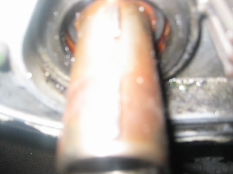

so after doing some research on the forums i thought i mite have some play on the crankshaft and because the woodruff keys have worn out so today i took it apart to notice the woodruff keys appear to be in good shape with no play and tightly fitted on.
so i have no idea what my next option or step is any help would be greatly appreciated. and sorry for the long post.
