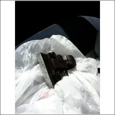

hahaha....wow, so i go to the garage before work (had to pick something up really quick) jack up the car and take a look through the inspection window(s), first thought was like...wtf looks like something blew up in there. I see the clutch fork and something else, i stick my hand in there and take out the clutch fork, ok that seems to be fine...go back in there and wat do u know its the pivot along with a piece of the tranny that it bolts on to...atleast from what i can remember it does bolt onto the tranny correct? Well the thing just snapped...talk about force. Here's a pic.

Sweet. I can't remember - is the broken part actually part of the bellhousing, or is it 1/2 of something that bolts to the bellhousing?

i really dun remember, didnt have much time to inspect it further...was running late for work, i need a picture of that side of the tranny

yea i just took a look at some bellhousing pics and it looks like it snapped right off...god hopefully i can find a bellhousing locally.
