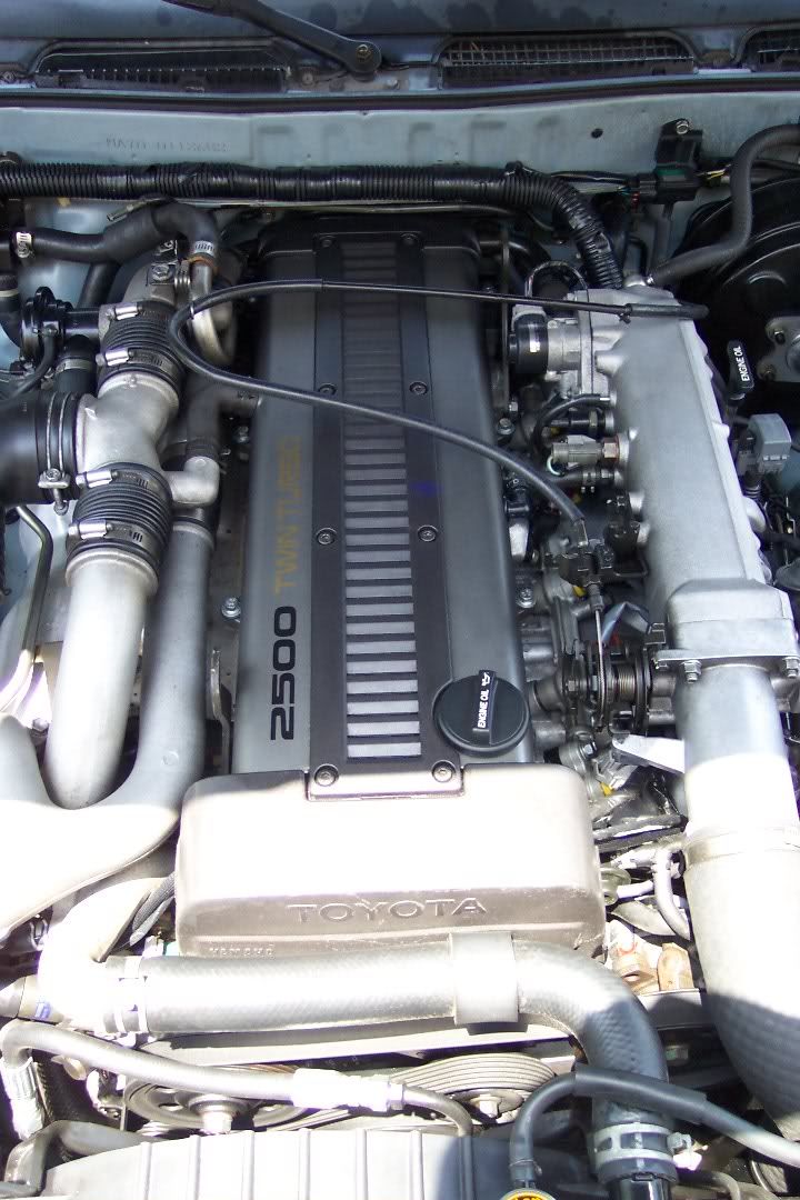

I used the 1JZ throttle cable that came with the clip. All I did was wrap it around the break booster once and connected it to the throttle.

people also use the 1jz cable that come with the clip.after it comes out of the firewall they go around the brake booster then to the trottle body.i ended up cutting mine down so i didn't have any slack

mine is on the same clip that was used for the RHD application. works for me

I did mine just like Joes.
I hate how mine has slack right at the trottlebody though. I cant seem to get the slack out for the tight therottle response.
