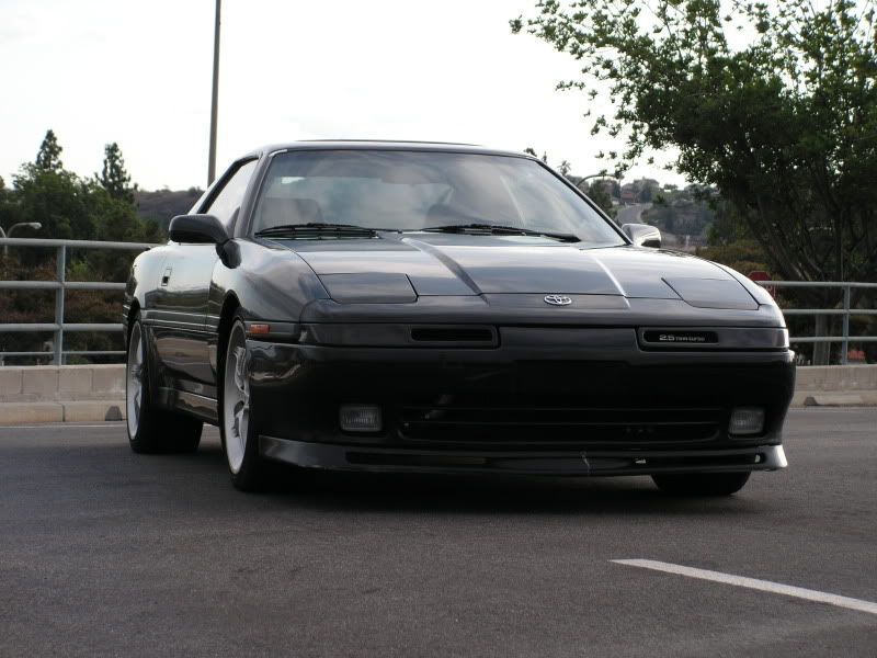

OneJoeZee
Retired Post Whore
5,721
aboard the Argama
I have a simple Trust IC that's a replacement for the stock IC using the same piping routing and stock piping if you wanted. It's not the best but a friend was selling it and it bolted right up, so that's what I have.
I'll get something better later. I'm not that worried about having a big bling intercooler. I'm not a big fan of big shiny exposed intercoolers. I prefer it to be less visible and it can still do it's job. Mine is just normal cast silver and hides behind the stock bumper/grills well. When I get a new better IC, I'll paint it black anyway so it doesn't stand out.
