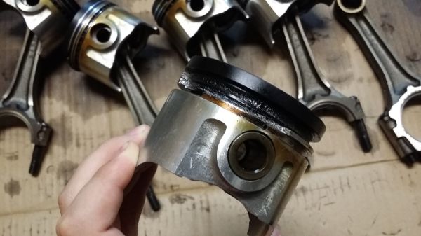

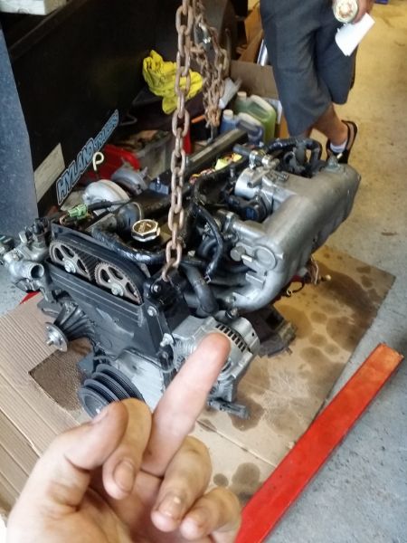

FIRST, THE CARNAGE:

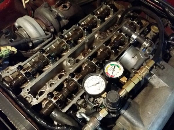

2 Broken ringlands.
Her putting away with #6 completely gone the same night it fucked off. I was going up against my friends 2011 STi with many bolt ons. Best part was we were neck and neck and I was down a cylinder haha. Previously I'd walk him so when I wasn't, I knew something was up. When I stopped, she wouldn't idle and I limped her right home.
(video^)
I was sitting around 375-400whp(comparing to previous dyno results, trust me it's accurate...) And I guess these NPR pistons the previous owner rebuilt with had just took enough, specifically #6.

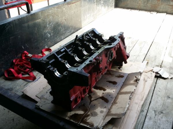

-Block honed and decked
-Crank polished

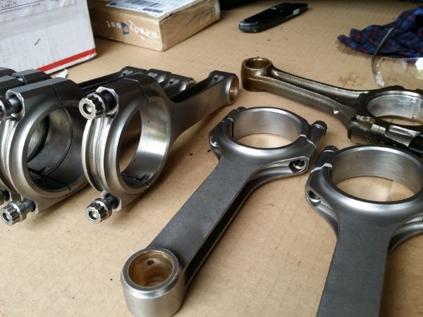

-Eagle rods

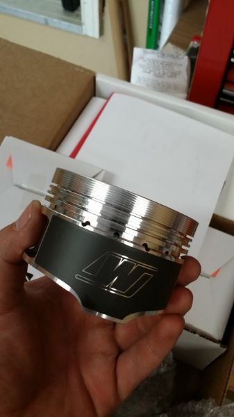

-Wiseco pistons

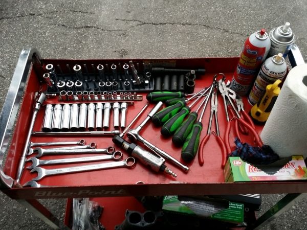

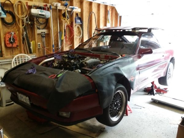

Most of the arsenal. If you attempt to do this, I suggest one of these carts. They're wonderful. That and being organized and clean.

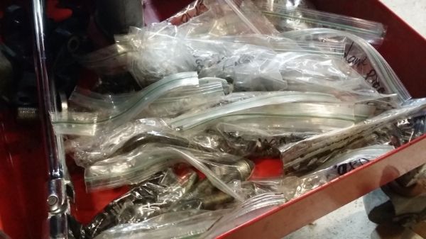

Got ziplock baggies??! I like to make sure I'm fully organized.

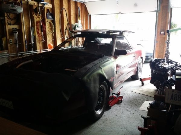

Cleanup day. Neighbors all looked at me like i had 2 heads. There's only 1 other person in this neighborhood that does things on the same level as this.

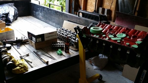

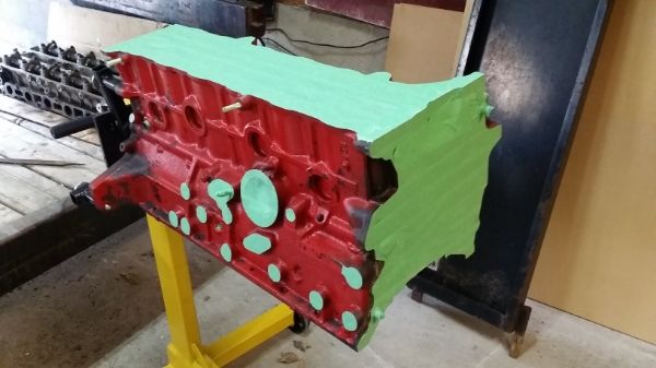

Prepping for paint. I. Hate. Sloppy. Paintjobs.

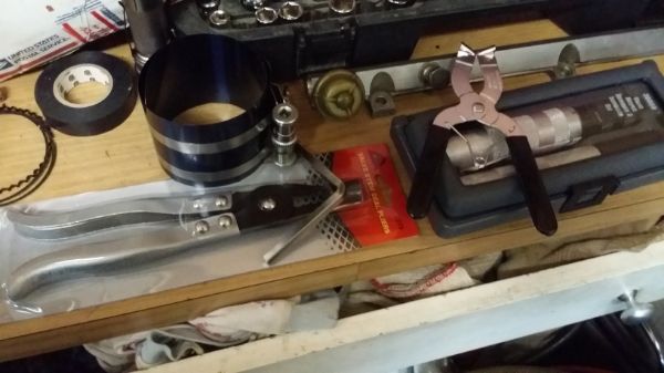

Some new specialty tools.

FIRST, THE CARNAGE:
2 Broken ringlands.
