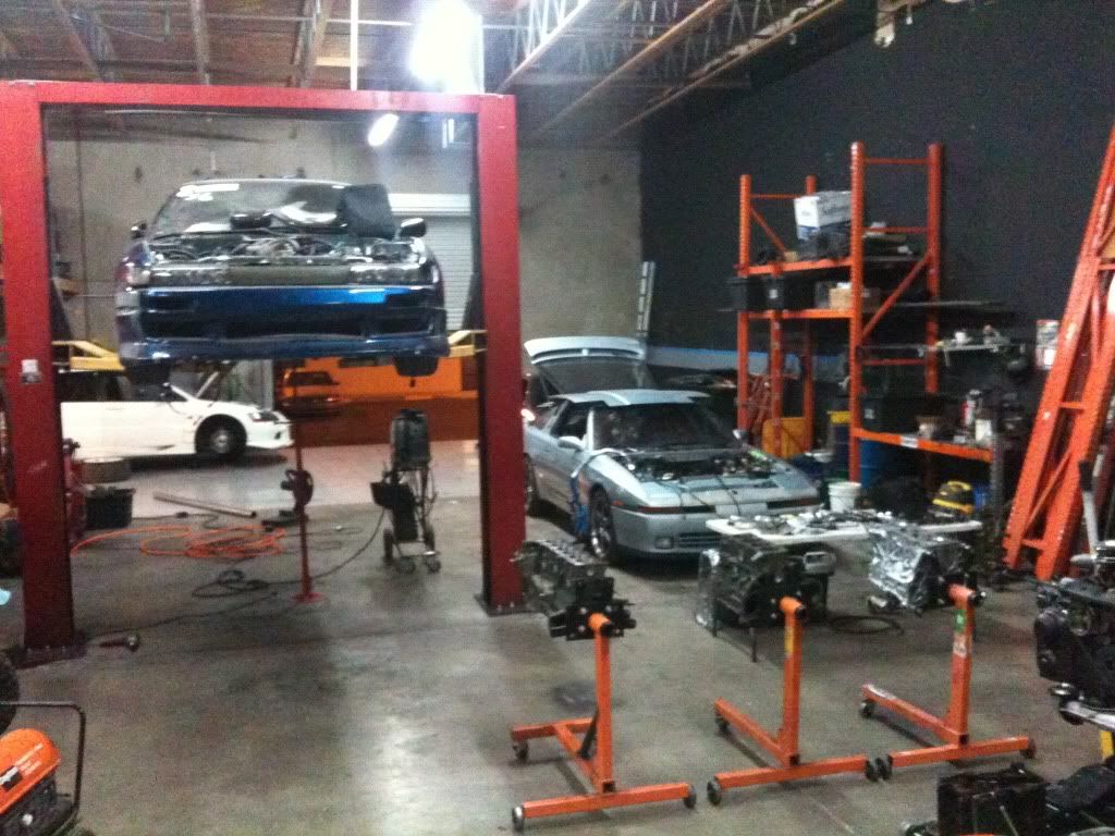

We just did a AEM pnp in that blue supra in the pic above.. It doesn't need anything but to wire in the torque converter lock up solenoid.
With megasquirt I would use a micro squirt stand alone to control the trans
