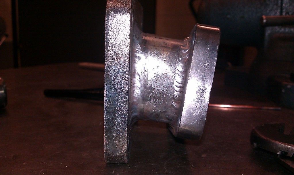

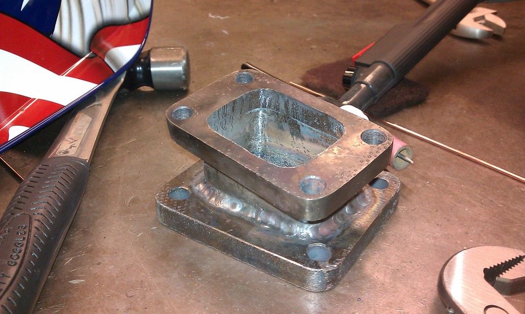

the hx35 is t3 i believe and you can use a t4 manifold with a t3 to t4 riser/spacer. i also believe the hx35 is twin scroll (divided). the flange is either a 5 bolt flange or a v band. either can be used.

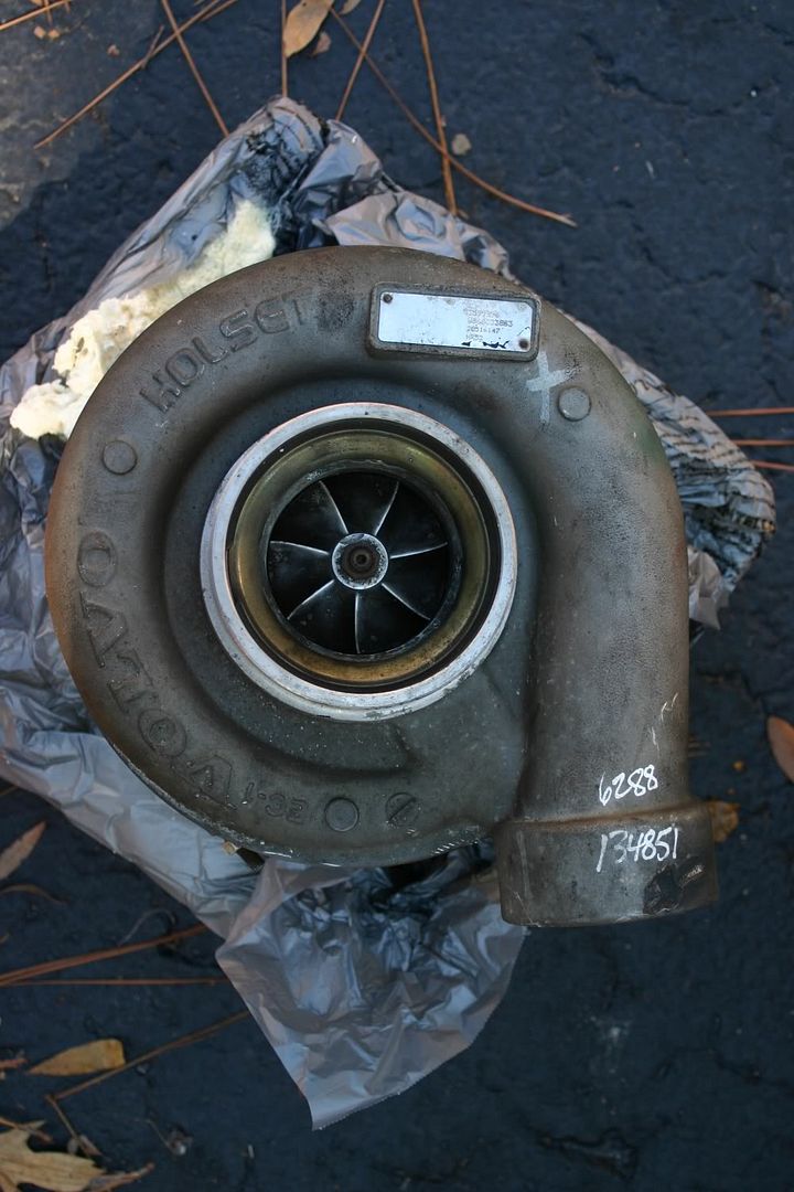

I have a HX52 "Super 52". It has a billet comp wheel. Excuse the mess, the car has a lot of zip ties holding everything together while I can fab up parts to mount stuff...
