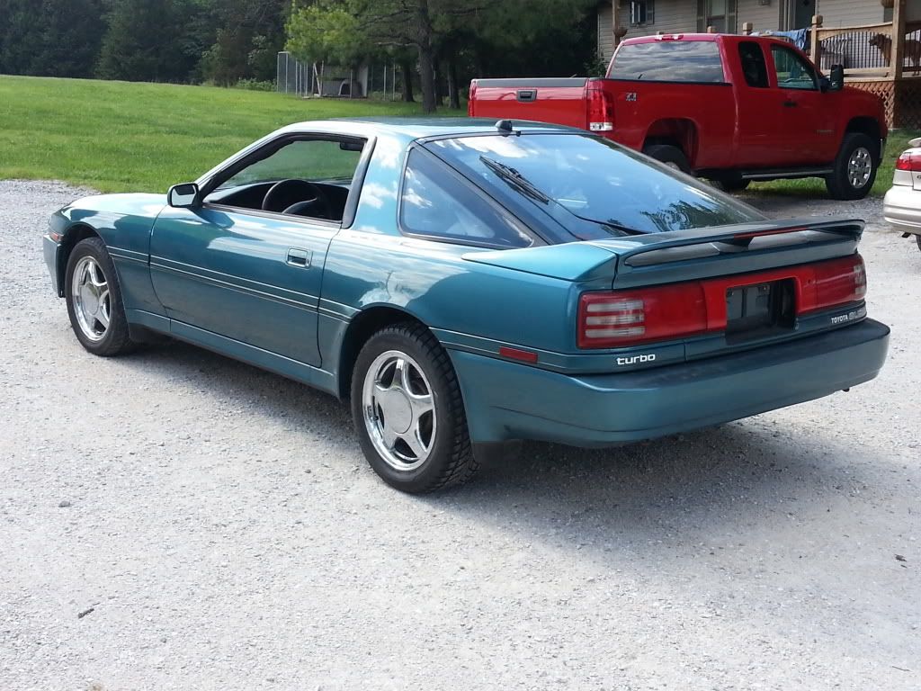

great looking car, if I would of had to put in new internals I would of bored it .20 over and put in new pistons making it a 3.2L but atleast you'll never have to worry about that bottom end again, did you just put in a oem headgasket or did you go metal? You don't need metal but if you plan to go over 400hp your going to have to rebuild the head later.
With the machine work mentioned, I HOPE it has a MHG. As for having to rebuild the head for goals over 400hp....not necessarily true, quite a few guys on here are/were making well over 400hp with a stock head. Not being a smart ass, just saying.
To the OP, nice car. :D
Lol. It would take ALOT more than .020 to make it a 3.2. You'd have to go to about 86mm bore.
I was implying the piston's and then boring it big enough to increase displacement. guess I didn't type that up to well. is this thing MHG then?
ttankers
Dec 12, 2011
Branson, MO
It's an OEM gasket unfortunately. I was at school while the rebuild took place and dad took over operations and didn't see the need for the metal gasket.

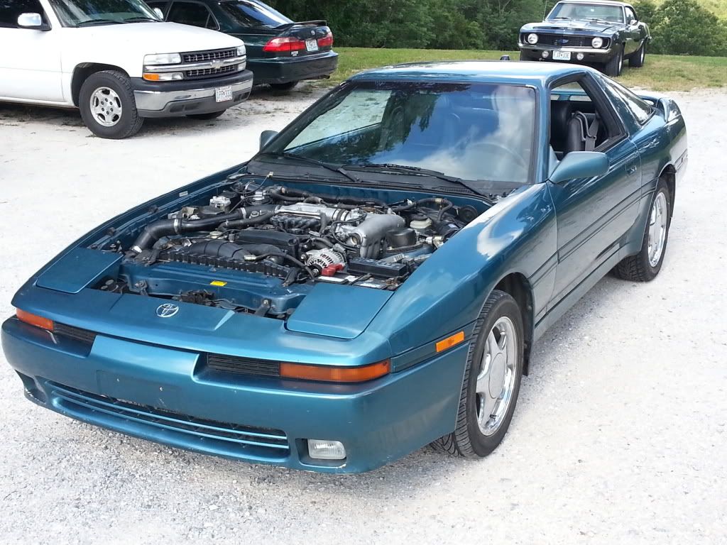

Just about to roll over 500 miles on the motor, getting ready to switch from straight 30W rotella to a synthetic blend. No more leaks anywhere, water or oil, and got the AC charged! More stuff works than I thought haha now time to start saving to replace my settled/clunking suspension.

Does anyone know if these wheels I have on here are very hard to find? I personally have not seen many polished/chrome 5 spoke stockers.

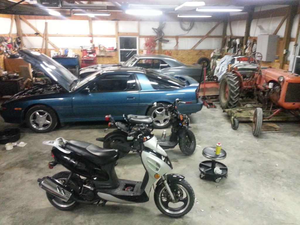

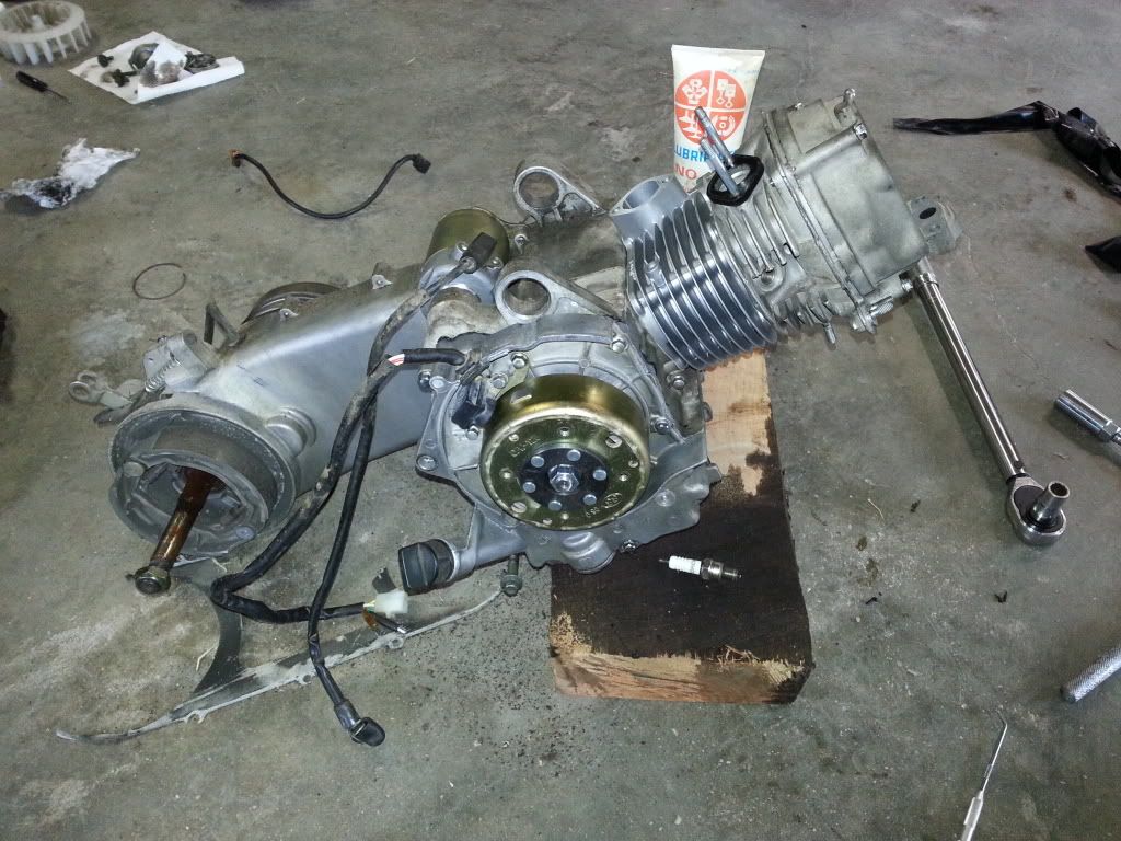

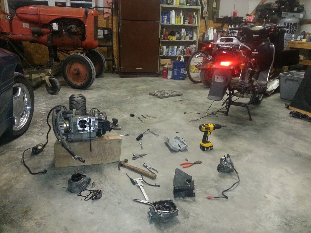

With the car done and on its 3rd oil change (running beautifully) and summer coming to an end, I picked up another project at the end of July for something more practical than the Toyota to get around at school.
Purchased locally for $125 lol
Ready to go back in
All done

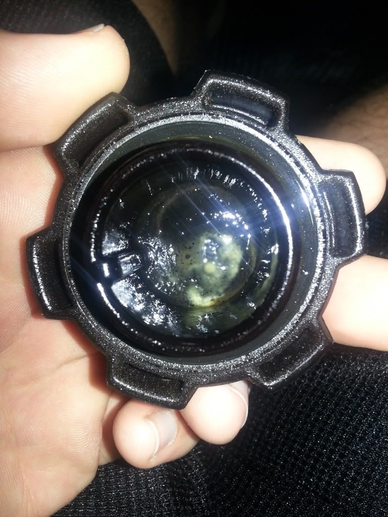

False alarm, condensation in the exhaust was exaggerated by the cold weather and my disappearing coolant might be the water in/outlet at the turbo, which must be burning and making its usual frightening stank.
Arp bolts torqued to arp specs on what I assume is an oem hg.
No overheating, but the other symptoms (steamy exhaust, coolant loss, smell, occasional miss on startup) turned me into a hypochondriac for the last week.

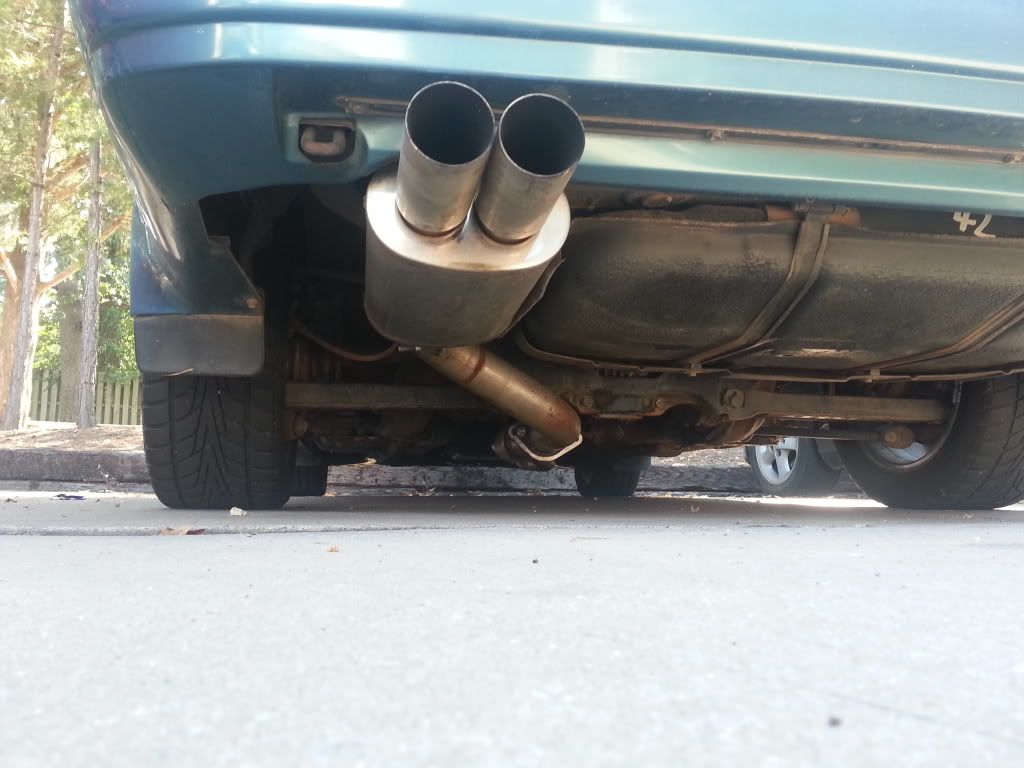

While I'm updating, last month I picked up a full 3 inch exhaust with magnaflow muffler and hks style dp for $100 total, and just bought a ruined r154 to rebuild over break for a swap hopefully next summer!

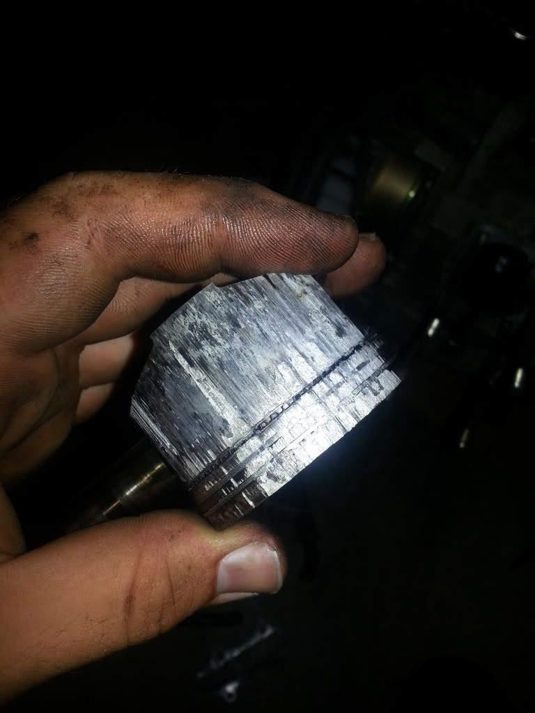

LOL ok now it's blown
Also either the builder didn't do a very good job on my valve stem seals or my fluttery bpv blew my turbo seals, she's been smoking (not like it matters now)
