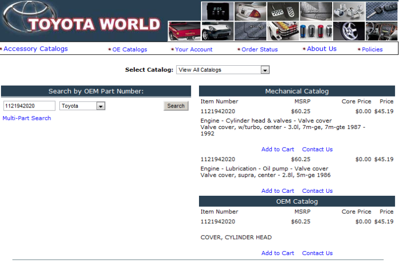

Why wouldn't you get a brand new #3 gasket from Toyota for $50? Looks Damn sexy and clean. Not to mention it keeps the top of the head looking brand new, both above the gasket and below...

That's what i'm gonna do but it's like $110 here at Precision Toyota

Be careful not to tighten them too tight. They came as screw from Toyota because it shouldn't have much torque at all. The screws are designed to NOT allow you to tighten it much. The bolts look and function much better, you just need to show restraint. It's tempting to clamp em down hard, but that wont help any. You'll just warp the cover.
$110?!?!?! I hope you're joking. You can get it shipped overnight from Champion Toyota for less than that I bet. With regular shipping from Champion its only $55. Tell your local dealer to lower the price or they lose business since they are price gouging.

unfortunately my dealer is the same way-I think champions prices are so much lower because they sell lots of items-and are just awesome. Valve cover gaskets are $12 from champion, and my dealer wants $50. That's per gasket mind you.
Holy hell, you guys are getting SCREWED. My local dealers are always within ~10-20% of Champion. If not, I'll call them on it and they've always met me in the middle. You guys are getting charged a HUGE add on profit for your local dealer above the standard Toyota pricing if it's really that ridiculous.
