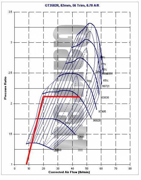

IMO a GT3071 is too small for a 7M. The GT3071 is also the smallest GT30 AFAIK.
Here are the compressor map for the 35R plotted out for a 7M. The upward slant might not be perfect, but the boost level is 18 psi.
Its borderline surging at that point; even worse on the GT3076R, and the 76 compressor wheel is bigger than the 71.
