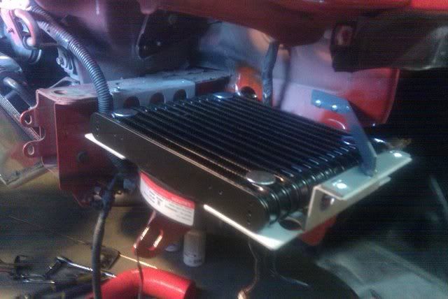

Just to clarify, make sure you just bypass the radiator altogether to the external cooler.
Mounting an external cooler under the driver headlight is pretty easy, here is a pic of mine mounted with the bumper off:
Tranny Oil Cooler w/ electric fan mounted under driver headlight
