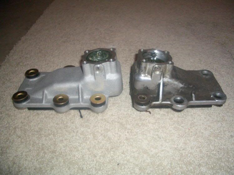

bigaaron;1004364 said:
You didn't ask him what year the SC300 was, early models don't even need the shifter extended... But yes, we can extend the Supra shifter.
what year did they need to be extended? 95+?
i kind of find it funny you guys didnt even read the links up there on how to extend it yourself Lol
pimptrizkit
thread killer
Dec 22, 2005
1,572
vancouver Wa
^^ aaron what are you talking about? Every SC300 swap with a supra R154 needed to have the shifter location moved back. I have a soarer R154 with me now from an Early model soarer (internal shifter), and it is extended with a swan neck shifter.
Dylan JZ
一番 King
Oct 18, 2007
2,220
湾岸せん
this as true of what I've seen so far.. all soarer R154 trans are the same utilizing the GT extension rod and plate.
