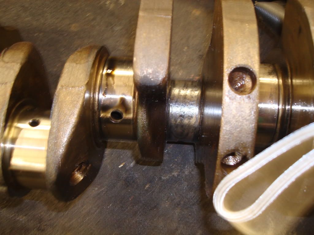

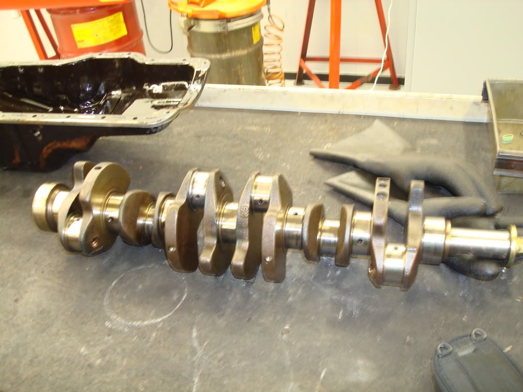

i found the pics of my crank. this is what mine looked like after the biggest beating you could give a rod journal. i had to pick off the cushed bearing. i'm sure if you pulled it appart it would be fine. i'm still not covinced you even have rod knock. i want to hear the noise.
