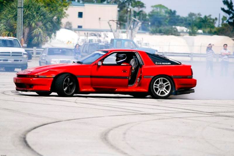

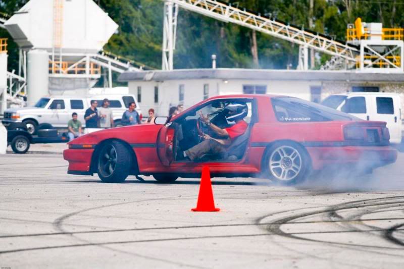

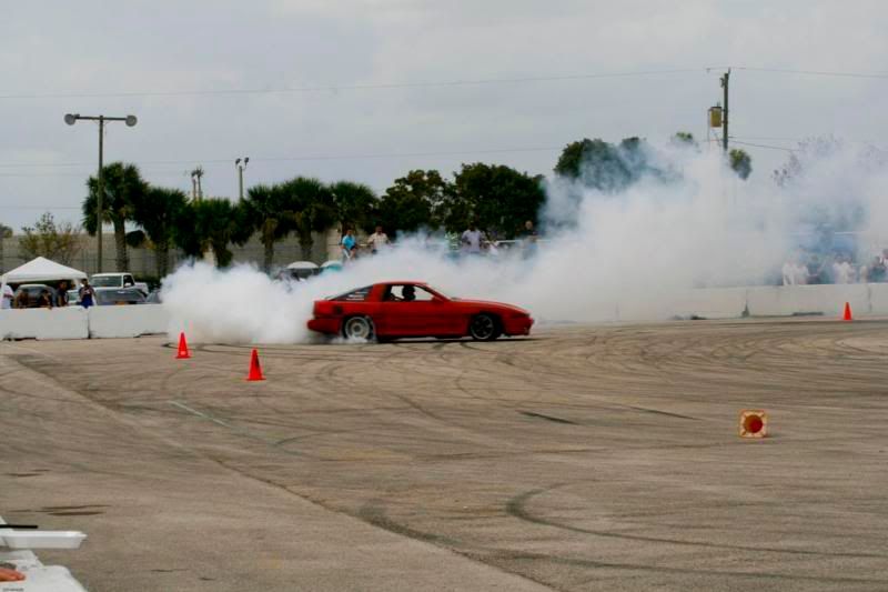

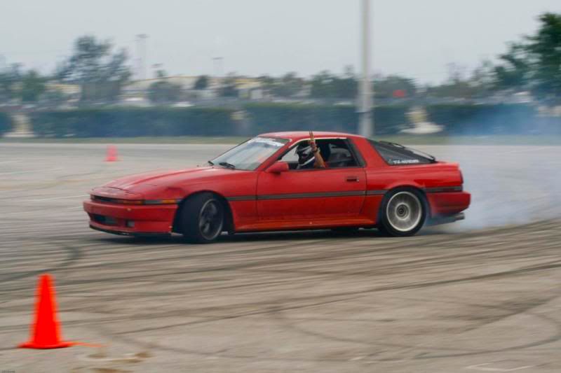

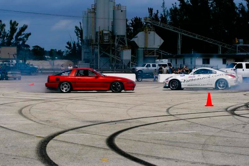

Hachi Bill @ Ter-tec event Feb 25 2007. He is a lurking member here. Looking really good on the track.

I see Hach-bill macking it big. Also making the MKIII a more popular drift car. Good Luck man!

ooh i remember his car. i wanted to ask what mod did he do to get more steering angle. I forgot to tho :wtc:
would be a super sweet mod for my auto x.

Sadly he wont be drifting a mk3 from what i understand, its just his daily driver. Seems to be the front under cover that is hanging down, or a bit of a cone.
I'll let him chime in with any other details so I'm not talking out my anus.

he's rockin TEIN S13 Tierods. But they barely fit the supra tie rod ends if my memory serves me right.
props to all the mods hes done to it though. Thats a heavy door to be swinging. lol :love:

i installed tein tie rod spacers from a s13/s14 tein tie rod kit. they fit, but you have to make sure they go in square to the shaft. the only problem i ran into with these is you almost run out of adjustment on the outer tie rods.
:naughty:
I'm currently building my self a suspension monster. I should look into this mod.

He swapped a 7mgte into an NA chassis. He has said in the past he'll go 1jz when the 7m blows...
Edit: Here is his modlist posted from another site:
88 n/a hardtop 5spd
87 7mgte swap
r154 with act unsprung 6 puck
short shifter
3.9 lsd turbo diff
walbro with relay mod
megan racing track coilovers
brand new toyota sterring rack, line and pump
s13 tein tie rod spacers
removed sterring damper and sterring stops
innovative turbo ballbearing 60-1 turbo
tial 44mm wastegate
n/a cams
cometic hg
arp bolts
hks down pipe
ported stock exhaust mani
open o2 housing
stainless oil and water turbo feed lines
550cc injectors
safc, vpc
greddy boost controller, and TT
autometer boost and water temp gauges
suprasport traction arms
