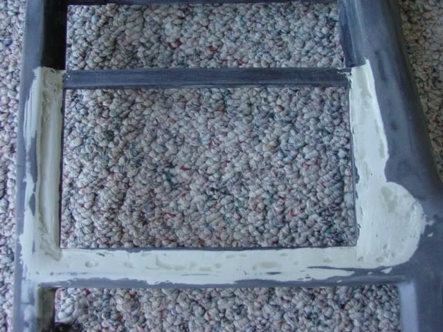

The "frame" on top of the HU faceplace is the Metra Late model Ford Kit 95-5812 or kit Ford 99-5807 as seen in this picture
I used epoxy to glue them together.
Filer material is SEM: Bumper Repair #68422. You can also use 3M Automix flexible bumper repair (cost more and better).
This is the first couple layers of SEM bumper repair.
I put a thin layer at a time. Thin layer give it an option to cure faster then 1 thick layer.
This one is after first 150 grid sand. Before that was about 3 passes of 60 grid sand paper. I just applied more filler to build it up after each sand.
