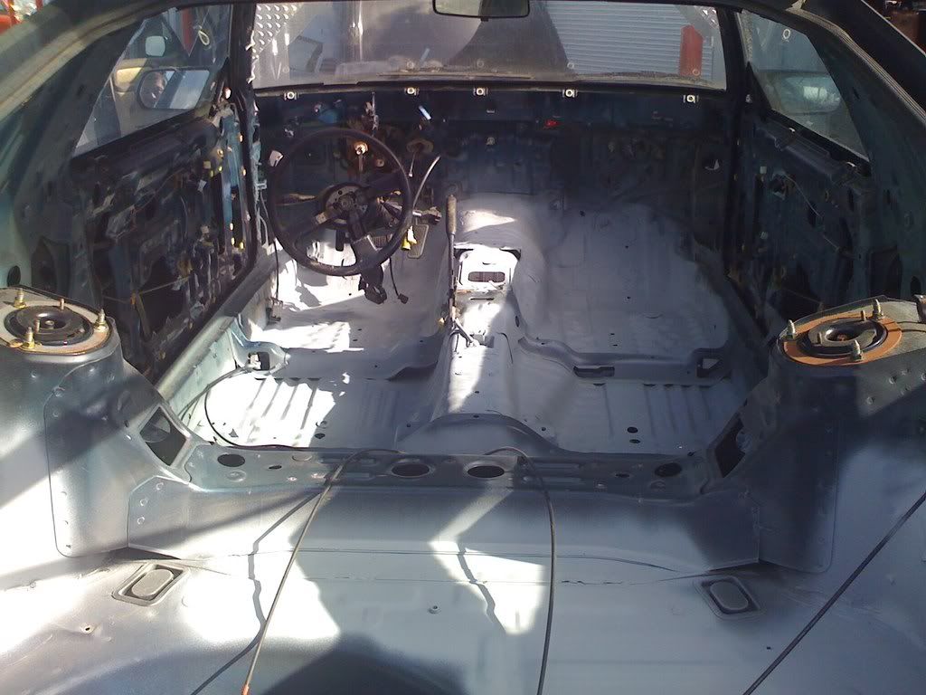

AGlobalThreat;925034 said:
How did you get it so clean where the sound deadener used to be?
get it nice and cold and chip it all off, and im sure there are solvents that will work with you. or you could use a wire wheel/flap disc to get everything pristine.
^^^ I used a wire wheel. It worked pretty well...
