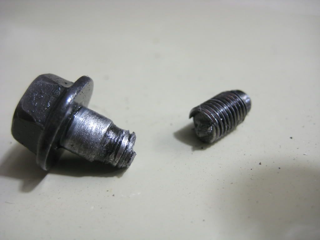

I am bumping this and adding a picture for anyboday that may have the same problem in the future.
If you didn't read through the whole thread.... I broke the trans, thought it was a shift fork, and it just turned out to be just the bolt that held the 1-2 shift fork to the rail

ive got three on there way with the final little parts i need for my build from champion. the last thing i want to do is pull my fresh tranny because of a 75 cent bolt. it should be all done this weekend. i also have tons of pics of the build and might just post them up for everyone even though its a pain in the ass when doing more then a couple pics.
