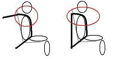

starscream5000 said:
Yes it does matter ;). If the belts are bolted down to the floor and you have a wreck, when you go forward the belts are pulling your body down (because they are bolted to the floor) thus causing spinal compression. When the belts are bolted down at a 45 dregree angle and you have a wreck, they pull you back because of the angle that they are bolted down to the bar. Take a look at any racing car and you will see that 99.9% will have a setup similar to the 45 degree angle.
i kno it does matter, but i still dont see how it changes how the seatbelt works.
if the seatbelt is coming threw a hole just above your sholulder in the seat, then goes streight down. the seatbelt would be at the same angel to your sholder from the hole as if it was going streight back to a harness bar.
example:
inside the red circle is what im talking about. what i mean is the angel of the harness to your sholder is the same regaurdless of where the belt is bolted. thats what i dont understand, im not saying your wrong, i believe you i just dont understand the resoning.
example:
i see what youre saying. the holes in the seat act as a fulcrum or pivot so the relative angle of the belt to the body is the proper 0-30 deg. there are 2 problems i see with using the belt holes to maintain the proper belt angle.
1. depending on the seat and driver, it may simply not give you the proper geometry. say, seat holes are a little low and a tall drivers shoulders may sit above the bottom of the hole.
2. racing seats are not designed to act in this way and cheap Corbeaus even less so. the forces acting on those holes during a crash could colapse the seat back which would obviously cause even more problems. this scenario would be even more likely with a recliner seat.
bottom line is, if you want to safely run a racing harness (5 or 6 point, dont even bother with 4 point) then you must use either a harness bar or a roll bar or cage. and if you do that, then the rear seats can not be safely occupied even if you have managed to keep them in the car. this is due to all the extra heavy metal hardware in the back.
