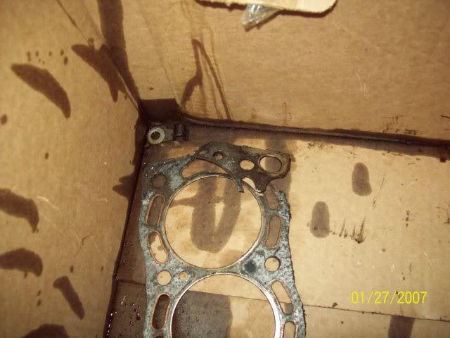

yea im changing my HG for the fun of it, cause it has 160K and i just picked it up and i had a feeling they never changed it since it was leaking oil pretty bad, and i did research on the BHG problem, and the HG started to break off once i pulled it off at the 6th cylinder, but no oil/coolant mix, so im lucky that im doing it now.
also i called the dealership, how does 114$ for the head-gasket cost? and one heard cheaper?

na my turbo seal was blown, which i already repaired, but all of my other gasket was leaking oil, this is my headgasket, but was not blown during of use time, the 6th cylinder was starting to rip apart when i was taking it apart, and i have done couple of gasket and motor rebuilds and haven't seen that before

that what a crappy original toyota hg will do.
