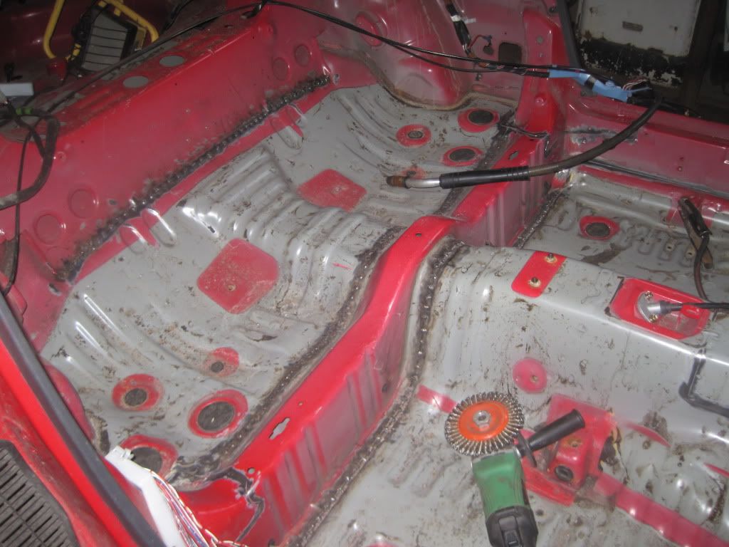

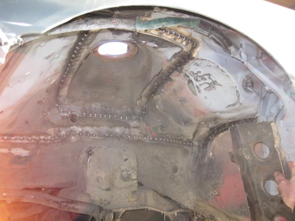

I did it
Inside/out - top/bottom
On a strippd bare targa
Took weeks
Maybe months
Then resprayed everything in epoxy
Not worth it unless your stripping the chassis for a resto. IMHO
I. Left front/rear areas between bumpers/strut towers alone for crumple zones
