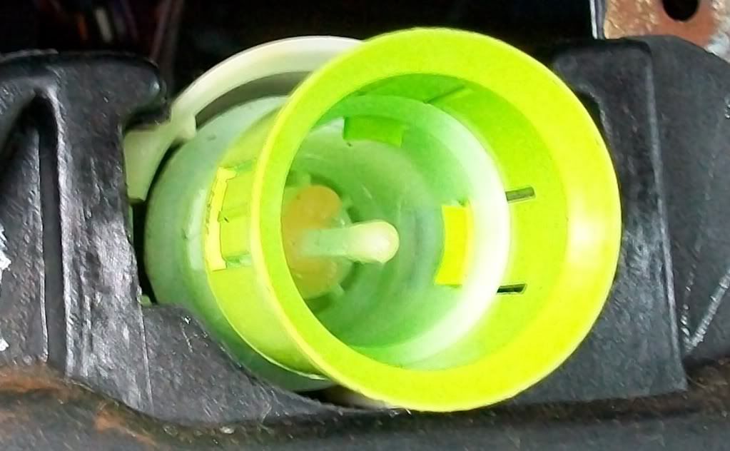

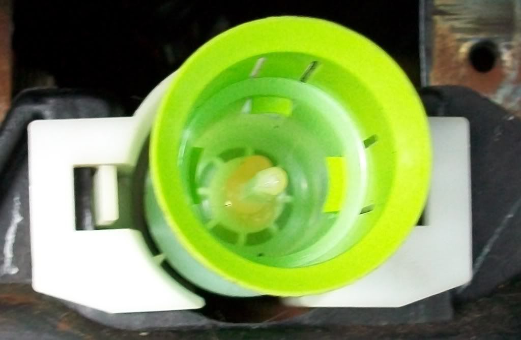

Can anyone tell if the nose is actually broken in half? i can not find any pictures for me to compare. I went in my pit and took it apart at the connection, and the needle does turn freely in the empty dash. clockwise and counter clockwise, but not in a small rotation, in a large rotation like it is bent. Is this piece truly broken? or can I just not get it in correctly? Thanks

*update*
i placed the gauges back in the car also on the speedometer cable, and went under the car with a drill and spun it, the speedometer moved about 20mph. So i believe the "long" cable is actually working properly, so could it be the small cable/lazy L thing? It seems it spins with a drill, but it is not being spun by the normal means. These two seem much more of a challenge to remove.
