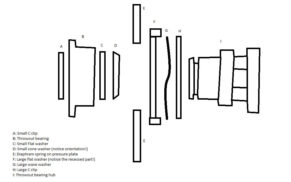

Poodles: Yes I believe I assembled it like that. And what I can see now makes me think it's correct. The only thing I can't confirm is the recessed washer and cone washer. What would happen if any of these were in the incorrect direction?

Poodles: If (F) is the wrong way around, is that enough to make the clutch not fully disengage?
Because I can see the disc move from the FW, but it needs to move just a tiny bit more.

What about if the large flat washer with recess (F) in poodles pic is facing the incorrect direction, could it be enough to make the clutch not fully disengage?
Is it even possible to install it in the wrong direction and get the c-clips on?

I'm thinking it might. Years ago I remeber a member having the same issues. His problem ended up being that he didn't put the hub assembly washers in correctly, and that was causing his problem. That thread is very old.

O It looks like the washer is installed correctly.
