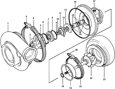

I bought a turbo from them almost two years ago, when I first installed it I couldn't build boost either, I figured out that the actuator arm needed to be adjusted tighter. A turbo with no seals and a leak would still build boost just later in the rpm band as long as the compressor wheel spins freely. I don't think the "leak" in your turbo bearing is even relivent to your boost problem, A leak that kills your boost that much has to be after the turbo outlet. I bet that if you put at least 2 turns on your actuator arm you will build boost just fine. Have you started the car with it installed and tried to build boost at idle?

The Seal in question is #16 on the list and has nothing to do with oil or water. The air is leaking from behind the Compressore #1.

Toy-Rific, Who is WE? Suprasport or I.T.S? I wanna know who I'm talking to here.
We have unmetered air coming in the system PERIOD throwing the A/F all over the place and the ECU trying to make its corrections.
We've already forwarded the Photos/Videos to suprasport and it shows where the leak is.

Toy-Rific;1014158 said:
WOW,
There are correct ways to test things and incorrect ways. By putting plugs on all the ports and sticking an air hose to the turbo would be incorrect....of coarse you should prbably be contacting GARRET and telling them they do not know how to engineer a turbo.
As far as the couplers. We use the exact same couplers on our cars and have sold over 17000 in 4 years, no one else has had problems with them. I beleive the way you are trying to do things and diagnose the issues are faulty and the cause to your problems....not the proven products.
Toy-Rific, are you with suprasport? Who are you speaking for here?
What is your organization's approved method of testing? Are you implying that Garrett turbos leak? If so, i'd double check that fact because we have 2 brand new GT35R turbos sitting here straight from Garrett and not 1 of them leaks the way this ITS does when subjected to the same test. Hell, they don't leak PERIOD.
Regarding the spooling issues, we just gave it a quick try once but we didn't push it at all because the car was running crazy lean and inconsistently due to the major boost leaks. But the question is, how are you going to build boost in your system if your compressor is leaking? The air will be coming out the back of the compressor instead of being pushed out to the IC and into the system. Your turbo could be building all the boost it can but you won't be registering it because that air is escaping and not going in your system.

Ah... so Toyrific is Greg... We're not attacking suprasport here. As Jeff mentioned, we've done plenty of business with you guys and you've been great. It's not your product that we're having issues with, it's the ITS unit. From what i understand, suprasport takes the ITS turbos and put on their BOSS housing on it. Great kit and perfect fit onto a stock manifold and setup.. We were actually very impressed. However the ITS turbo itself was leaking for us and you guys had nothing to do with it, unless you test each turbo you get. Just like us, you wouldn't expect the new turbos from ITS to be leaking so you didn't bother testing them. We only tested it when we ran into the problem and started diagnosing.
Garrett puts an orange gasket right there where the ITS turbo is leaking..

SupraSport has made arrangement with CompTurbo to give this turbo a complete inspection and repair if needed. This turbo came from ITS and not from CompTurbo. There will not be a charge to the owner for this service. SupraSport did sell this turbo in June of last year. We stand behind the turbo's we sell.
Yes, We are SupraSport (Jack) and Lipp (Greg) that is why we are doing a reply here.
On the Boss Turbo's we sell, you may need to shorten the rod end of the actuator arm to increase the amount of boost. The more boost you want, the shorter the over all length of the arm will do the trick.
You will not be able to pull the rod end back on, so a little air from an airline hose will do just fine to re-connect the arm
