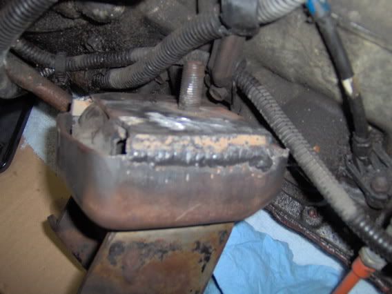

Hate to bring up and old subject but.... have any of you running solid mounts broke anything else that could be caused by having solid mounts? aside from the vibration at idle is seams ok. i'm just worried about the aluminum brackets that connect the mounts to the block breaking.

After about 230 h.p. the mounts tear in half?? what's the H.P. cut off point before they tear?
Not doubting you, I'm just trying to learn.
