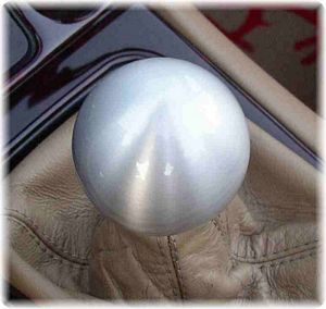

Best thing is cut weld tip because the shaft diameter is a little larger the the 12mm thread size and would take a little grinding but there is a piece pressed onto it where the rubber sets etc I just welded mine together to save time and extra work.
A verry good shift knob and threaded at that is the Team Voodoo miata club shifters they sell titanium steel polished brush etc great price $35-$45 and threaded just right here is the link http://www.thompson-automotive.com/voodoo.html In my proffesional race opinion they provide perfect counter weight and are perfect diameter to palm in the hand! they are threaded so unlike 95%+ of the aftermarket knobs they dont fall off cuz crappy set screws
With the sogi mod + the team voodoo i hit 100% of my shift clean easy because the shift knob does the work with the weight.
Some pics of there varrious knobs make sure to let them know its toyota threaded also!
The best knobs i have found so far!!!!
Unless you can find the verry rare metal TRD shift knob instead of the crappy leather one that falls apart after a while.
