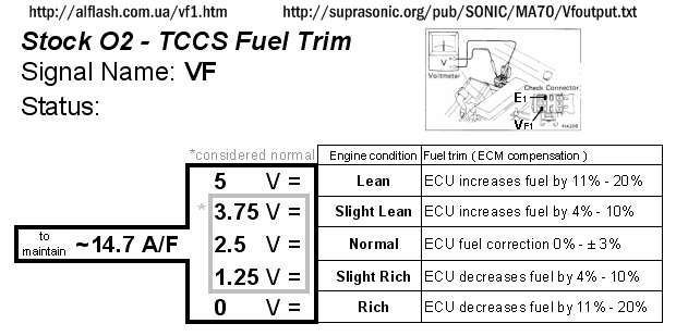

Also measure the voltage on the Vf pin of the diagnostic connector. The expectation is that it will be 5V per below.
Courtesy of ISNMS...
