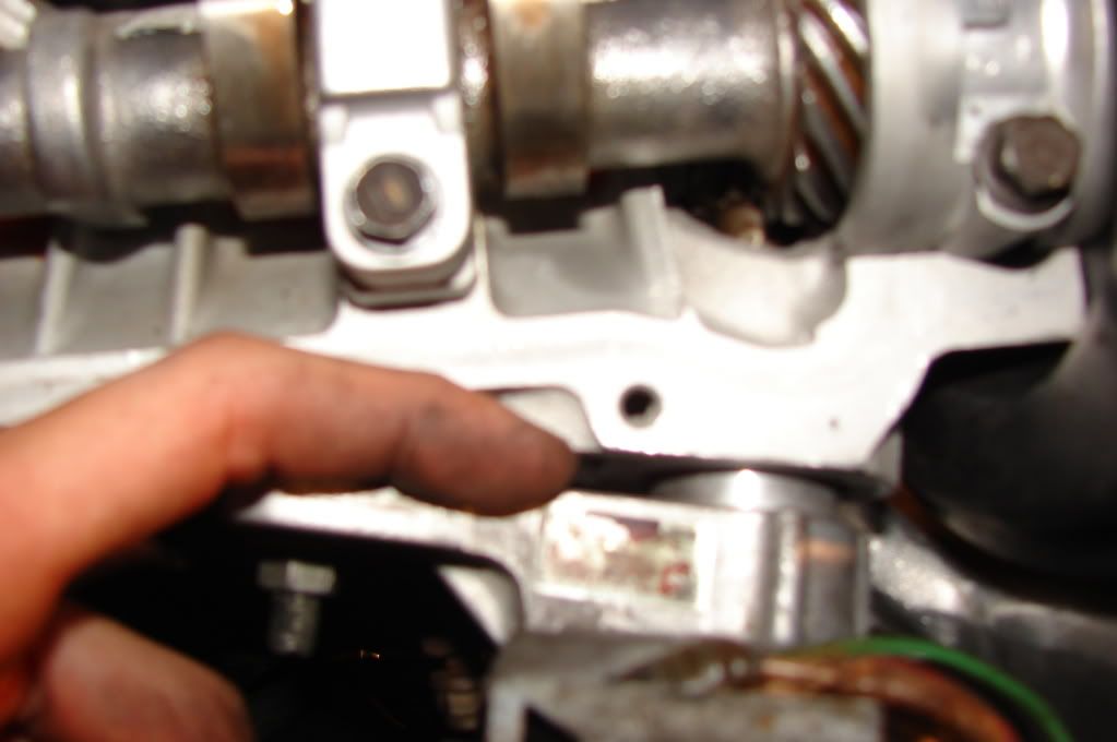

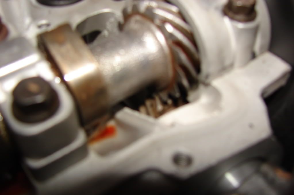

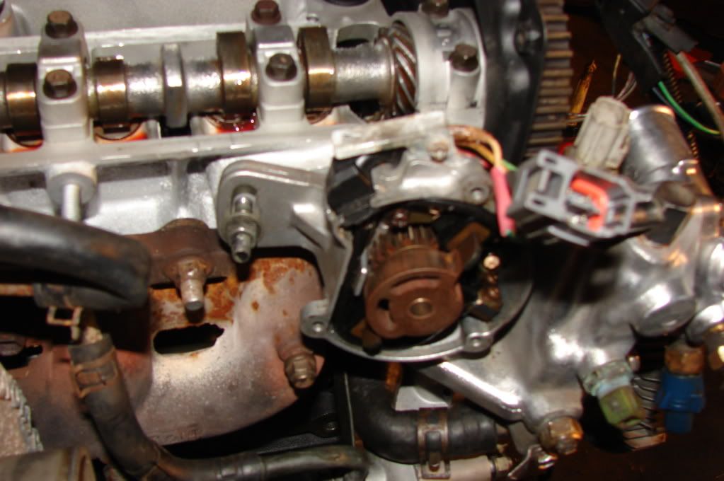

OK long story short, the entire body of the CPS will not slip into the tunnel it is suppose to. On the exhaust cam, the gears of both the cam and cps are together. The issue is there's about a half a inch of space between the head and plate the cps is on. I have some pictures of it ill post in a sec, but I have done a few searches and found it looks to be they are suppose to be flush. So I have no clue on what i'm suppose to do.
On a side note, I did have the head rebuilt, and they sprayed spray paint on the head, im thinking there might be a larger build up of paint in that tunnel, so i'm going to try using sand paper, and wear away at it. But ill see what happens.
TweeT91109
Jan 7, 2010
738
Tampa, Florida, United States
No it wasnt needed, I used acetone to get the slight build up of paint out of the tunnel, its in now, and sitting flush. Ill probably have to readjust when I get it first started...but for now, its on and im happy.
