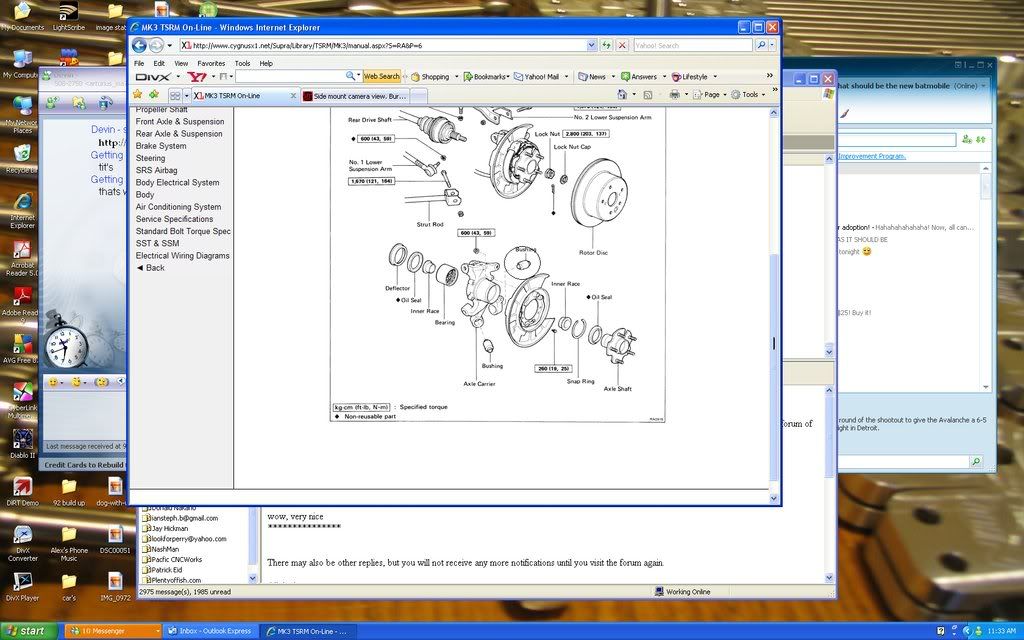

Thanks for the detailed info CJ! After looking at the video carefully again, I do see that the toe in is the most when the rear suspension is at the highest. However, I imagine that new/poly bushings would help a lot, since it does still seem to have more play than it should.
If both wheels toe in under compression, then wouldn't that really screw up launching and acceleration of a car with lots more power? My suspension looks to compress at least 2" under load, and I assume that having both wheels toe in would be more likely to lose traction. What do the Mk4 drag racer's do? Do they set up the rear to toe out with positive camber so that under heavy squat it squares out? How could you maximize the flat straight contact patch on a street car? Stiffer rear springs?
