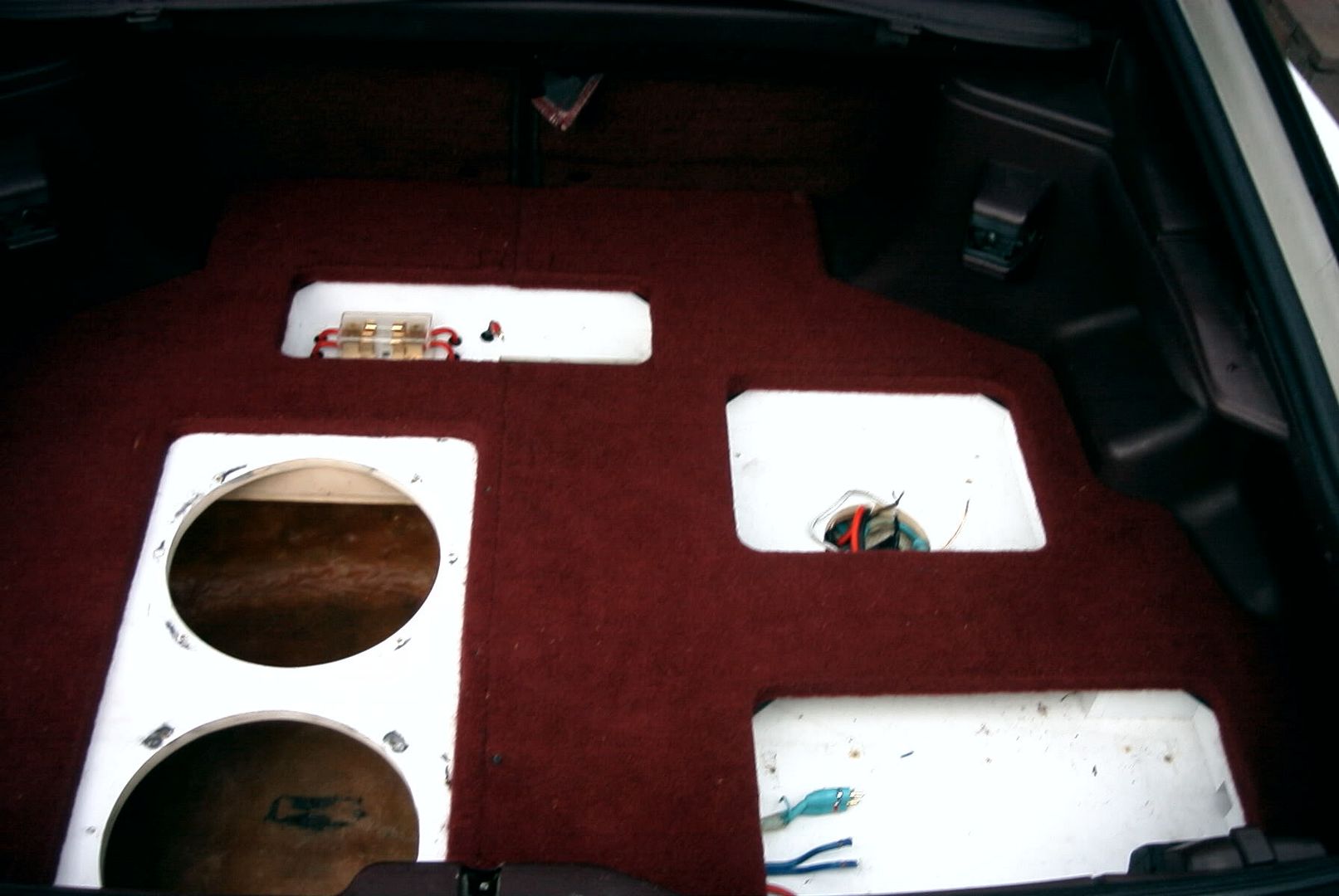

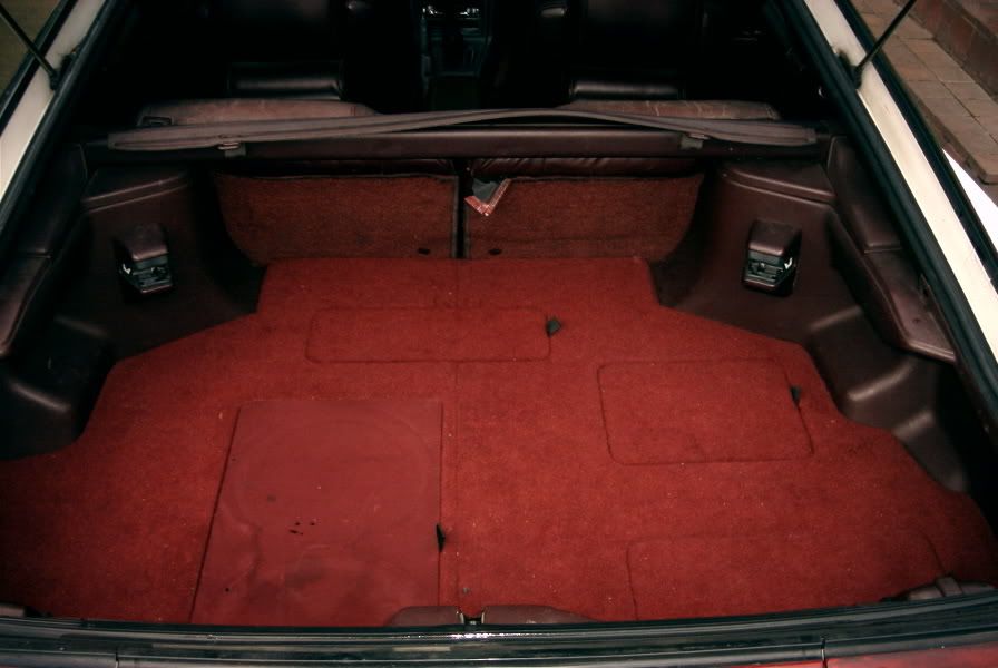

this is my little set up... dont have anything in it right now...
2 10 inch sub box... all fibreglass. :biglaugh:

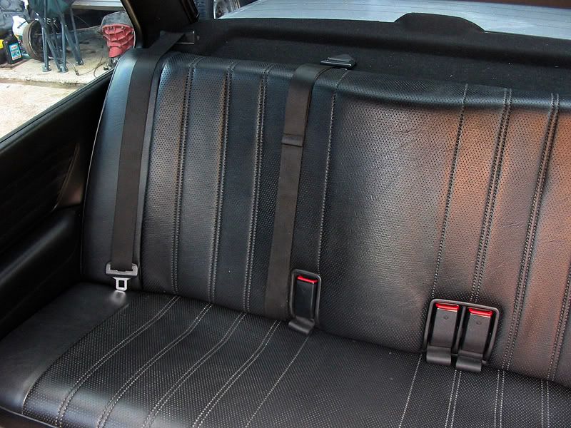

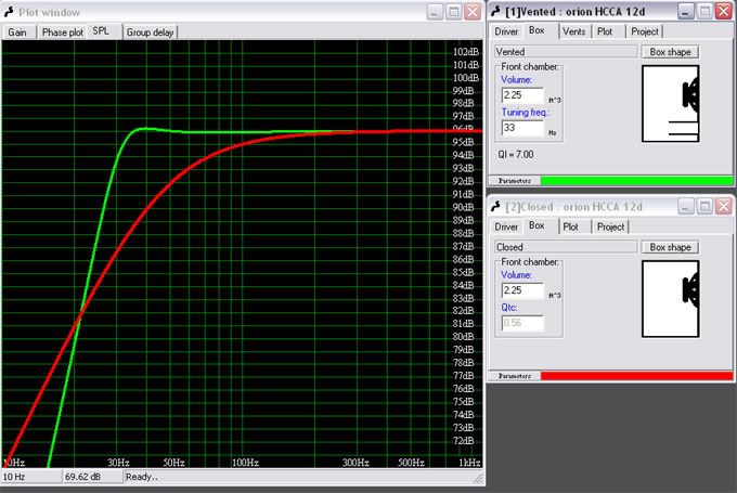

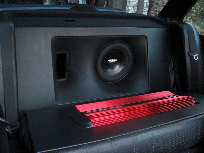

This is the install I did in my BMW, sorry no set up for my sup. But maybe it will help with ideas ;) BTW behind the seat was solid metal, I had to cut an opening, had to fab the kicks, door pods, rear set up I had to make a fold down rear seat out of a solid seat, well just about everything is custom. The one sub is running at 1 ohm, the four fronts are at 2 ohm per side.
Ok this is the head unit, Eclipse 55060
Here is the sub, Orion HCCA duel voice coil 12"
Here is the amp, Orion HCCA 150R
Here are the comps, kicks have MB Quart 6.5" (the doors have kappas....for now)
Rear seat up (and usable!)
Rear seat down,
Here is the calc for the enclosure (ported / green line)

I had a set of Orion’s running on a Tsunami amp back in 98, it was an awesome setup. They were a very good Sub. I haven’t kept track of the company lately, so tell me, jimi87-t, how do they sound these days. Has Orion kept up there high quality? They were a damn near indestructible sub back in those days.
And how are their amps?

Thanks Johnathan.

I don't know about their quality now a days, Orion was bought out by DEI IIRC, and this set up was bought before that, the HCCA line was the best from Orion. These are a 1990's run that they had going and is what gave Orion their rep of being one of the best. I've been in the audio feild for a long ass time and wouldn't want anything else. Bad news is, I wouldn't trust their new stuff after the buy out, and you'll be hard pressed to find some good HCCA stuff for sale. This set up has seen a few of my cars threw out the years, and I've had to replace head units and mids and highs but have yet to make the amp and sub "miss a beat".

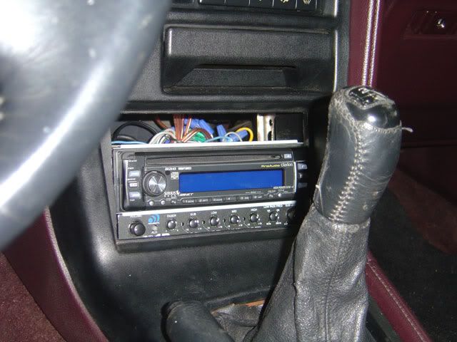

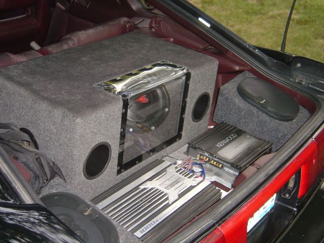

nothing too great, but i have pipe dreams to have something a little more custom and clean some day. that probably won't happen until after I get new shocks, springs, rims and rubber for the supra and video, carputer and amps + speakers for the tC.
This is what I've collected over the years.
Infinity Reference speakers
3" in doors
4" in rear panels
5.25" components on floor in front of front seats
6x9" in boxes in trunk
2x10" DVC Concept subs
2 Kenwood amps, 1 HiFonics amp, Fosgate cap, Clarion HU, Massive EQ
