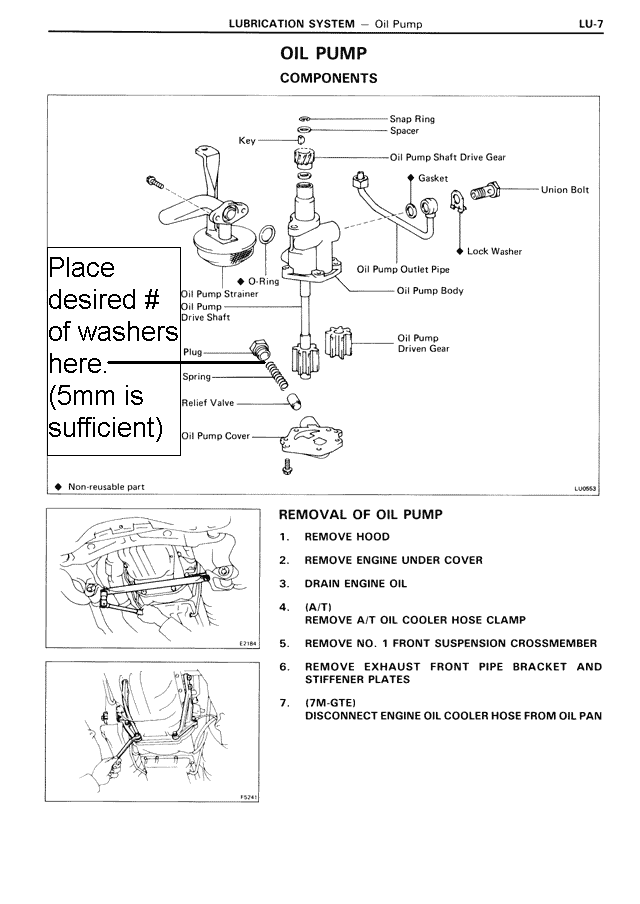

Basically, all you do is place between 5mm of washers in where it says in the diagram, and it'll raise your oil pressure a decent amount. I'm in the process of doing this now. I'll post my findings.
I was told by another member (IJ) that 5mm of washers will suffice.
IJ. said:
A good analogy: the relief acts like a wastegate for the Oil Pump and if you shim it solid it can't open and something has to blow!
By this, Ian means that if the relief can't open, that you'll blow the weakest point in the oiling system, most commonly the o-ring on the oil filter, or in extreme cases, the oil filter itself!
I also spoke with flubyux2, and he suggested that the washers go right inside the hollow bolt, and that you should use washers instead of a solid piece of bolt stock to allow oil to still flow through that bolt. (what Aisin intended for it to do) Thanks for the info, Chris!

so what type of increase are we talking 10 ,20 psi and why does that make a difference????
yes what kind of increases are seen from the 5mm washer?
my oil press seems fine while driving (40+)but it drops alot when im at idle (15-20), makes me nervouse..

SOOo... how much psi is gained from a 5mm washer mod????? thnks now...

lol dont get scared abotu your oil pressure, aslong as its above 5 at idle your fine. and at 3krpm it should be 35-40 if i remmeber right
