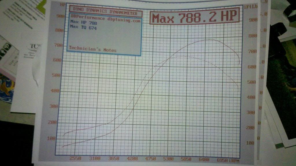

As has been said before, it depends a lot on your power curve. My power band is relatively high, but it still drops off. While I will happily rev the engine to 7500rpm, it isn't making power up there. I usually shift at 6700-7000 so I don't drop out of boost, as well as having my power and torque still. Not that it is fine-tuned by any means, I need to get a transmission that stays together before I can quantify this thought process.
Take a look at this sheet and see why I do what I do.
Edit: Here's my older dyno graph before I felt comfy spinning the engine that high, back then I shifted right before redline ~6400rpm.
