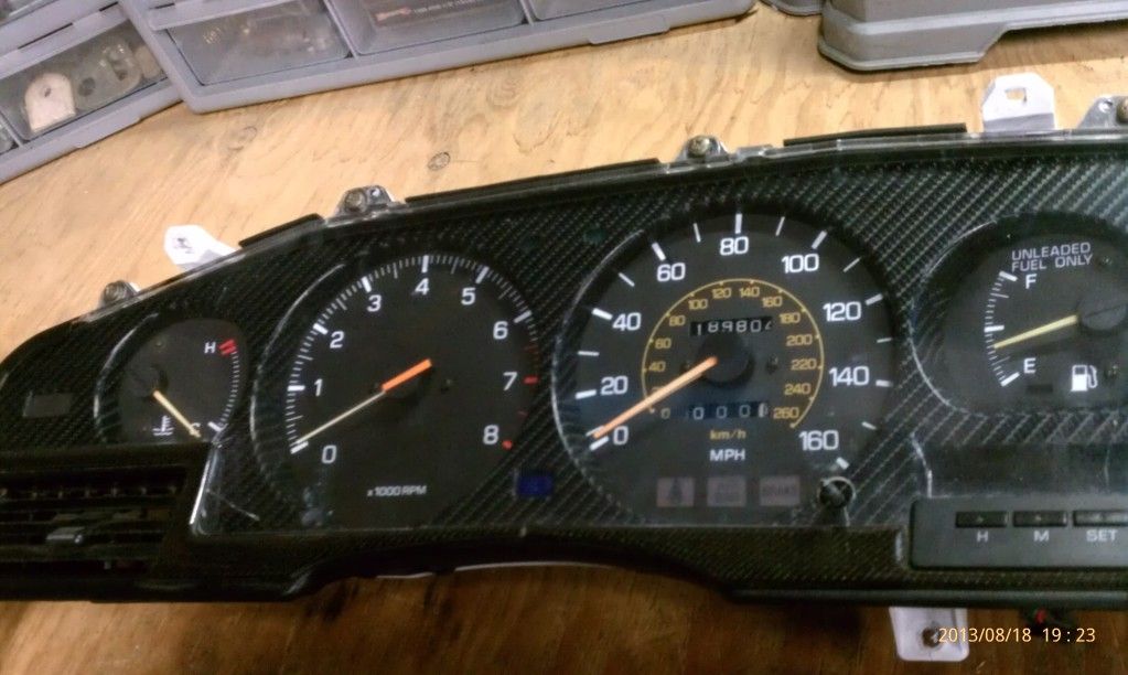

sheedy126;1959520 said:
Wrapped my gauge cluster bezel sp* today.
Turned out pretty good
Sent from my PC36100 using Tapatalk 2
I've been thinking of doing this for a while now. Where did you get the wrap?
