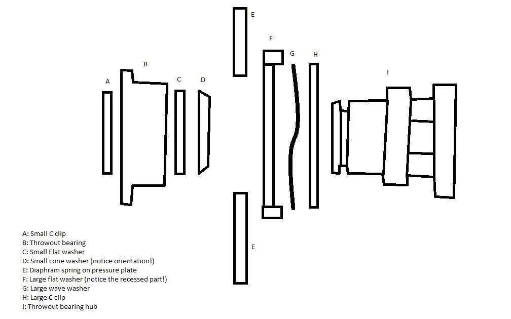

Sounds like either the clutch hub is incorrectly assembled, or it's worn out from being incorrectly assembled.
This is how it should be assembled:

Ugh so you're using the thrust bearing destroyer. Honestly, that pressure plate is nothing but trouble.
Outside of that, the clips may have been installed wrong (i.e. stretched too far)
