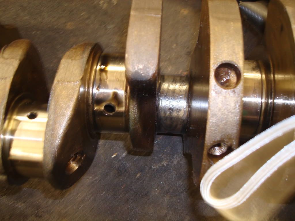

sorry to say but expect to see something along the lines of this when you see the crank...

Better save more than that :icon_bigg, if your doing things right youll spend half that on just machine work, especially with head work
you may quet things down a bit with new bearings but I doubt it will last long as bad as it sounds. If your going to do all that work why not pull it right, have the crank ground or source a new one and get new bearings, It would be just as fast other that time sourcing parts and machine work, just my .02

And if the crank is bad, your Frocked!!
You can't get it out without taking off the crank pulley, front covers, flywheel, and rear seal carrier.
So in other words, save yourself some unnecessary work, and just take the engine out in the first place.
