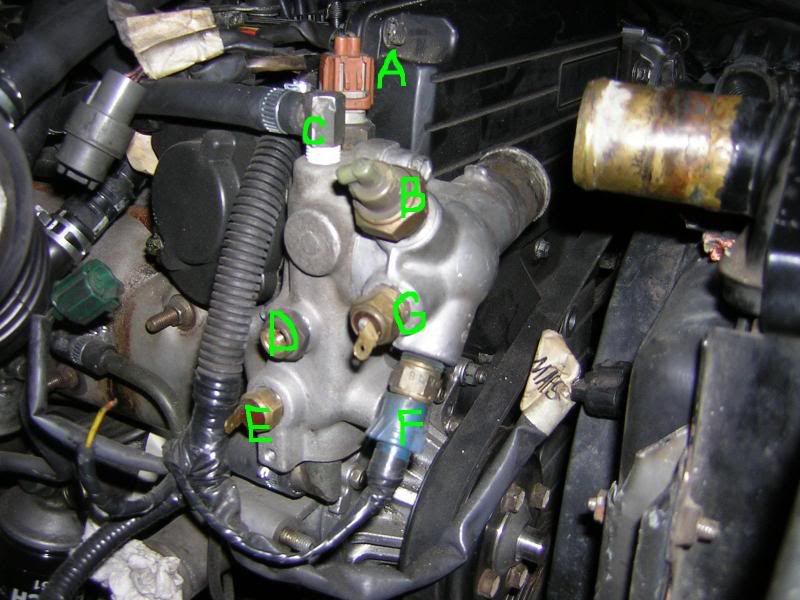

Wiring on the coolant housing:
A is cold start injector timer
B is BVSV for charcoal can (gone)
C is coolant to turbo
D is Engine coolant temp sensor (for TCCS), green plug goes to this, broken
E is ?
F is Temp sending unit (for gauge)
G is ?
Question 1/2: What are E and G? Wire color for one of them?
Question 3: Where does the vacuum line on the bottom of the accordion hose go? ANS: P/S, now to be capped since I do not have stock P/S. Thanks Cryoslash

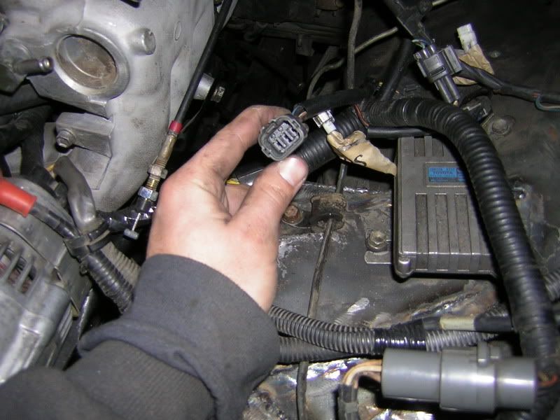

Question 5: Mystery plug (battery area under a supra hood :)). Any info appreciated. Wire colors: Blk/red, blk/org, blk/yel, blu/wht, wht/brn (last wire has a stripes of brown that are radial, not linear)

just out of curiosity... i saw this pic and the thing circled i have it but its not plugged into anything. what is it?

Question 3 = Power steering idle up. You can simply block it off. I had mine burnt by the exhaust manifold, and couldn't figure out my vacuum leak, but nothing was irregular, just i heard the leak.
So yeah i'll answer more upon further review.

well if thats for the o2 sensor and the ECU uses it for the AFR's and its not plugged in.. how would the engine know what kinda oxygen content was in the exhaust

89turborunner
Dec 18, 2007
oregon
CryoSlash said:
Mystery wire, might be for the fans? Not 100 percent on that one.
A/C fans? I do not have A/C. I am converting to an electric fan though. I would REALLY like to use stock stuff on the motor to operate my relay... I am broke right now and don't want to spend $33 on a darn fan switch.
Other info- I have no A/C system at all, and I have nothing left of the stock P/S system either.

jon_570 said:
but my car runs fine...
With no O2 sensor? Well, I suppose that it will, the O2 sensor is used by the TCCS to alter the fuel maps in both long and short term modes. Without it, it has to assume that the factory maps are correct, but it will probbaly correct to max rich, just to be on the safe side. This is bad for both power and fuel economy, but it'll run, and reasonably well, assuming that both the AFM and TPS are working properly.
At idle and WOT the O2 sensor is ignored by the ECU anyway. These are "open loop" modes, where there is no feedback to the ECU.
In closed loop mode, the ECU learns what the actual fuel mixture is, and starts to adjust its long term program, which it then adapts for WOT processing.
However, no O2 sensor should be throwing codes, and lighting the CEL. It'll run still, but it's not a good idea.
I meant the stock electric fans on the rad. the aux fans.
