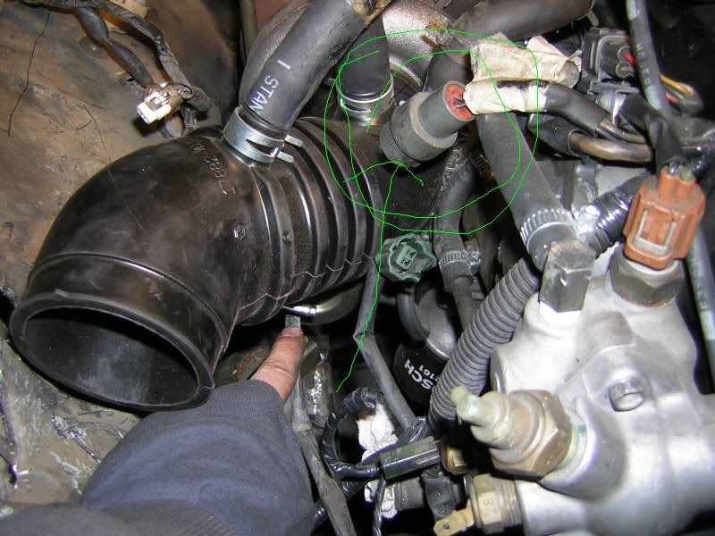

Wiring on the coolant housing:
A is cold start injector timer
B is BVSV for charcoal can (gone)
C is coolant to turbo
D is Engine coolant temp sensor (for TCCS), green plug goes to this, broken
E is ?
F is Temp sending unit (for gauge)
G is ?
Question 1/2: What are E and G? Wire color for one of them?
Question 3: Where does the vacuum line on the bottom of the accordion hose go? ANS: P/S, now to be capped since I do not have stock P/S. Thanks Cryoslash
Question 4: With EGR deleted, vacuum line goes: manifold--->FPR VSV-----> FPR, correct?
Question 5: Mystery plug (battery area under a supra hood :)). Any info appreciated. Wire colors: Blk/red, blk/org, blk/yel, blu/wht, wht/brn (last wire has a stripes of brown that are radial, not linear)

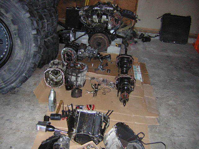

In case anyone forgot the project... here are a few old pics:
Custom hybrid tranny

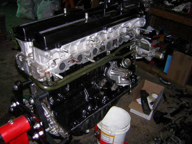

First rebuild I have done

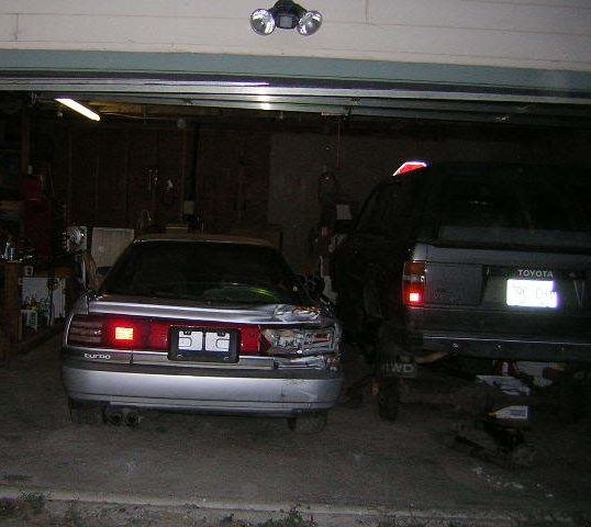

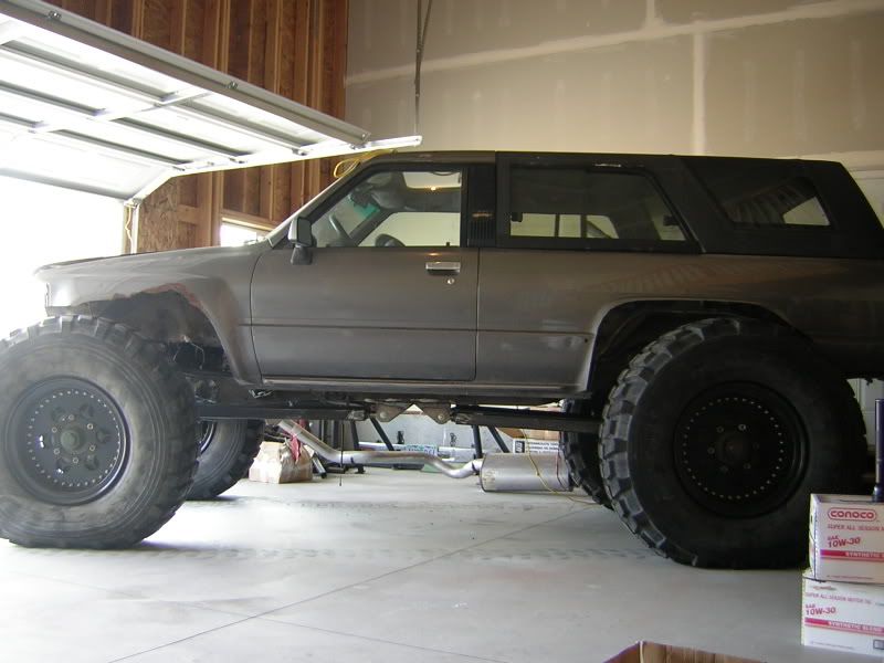

Old pic, half done (yes, the fenders are now cut way above the tires). Garage look different? This is after the move.

Question 3 = Power steering idle up. You can simply block it off. I had mine burnt by the exhaust manifold, and couldn't figure out my vacuum leak, but nothing was irregular, just i heard the leak.

Original post edited, Conclusions thus far: No post turbo AFM, accordion hose vaccum is P/S (I don't have this kind of PS), so it will be capped.

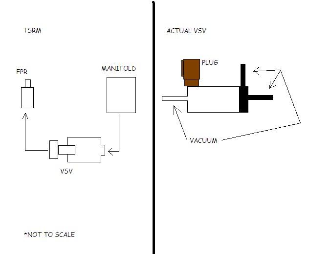

LEft side (called TSRM), is my attempt to represent the vacuum/fuel diagram on mage FI-3 in the TSRM. It shows two vacuum ports, but the VSV really has 3. This is for the fuel pressure regulator VSV. AFter some digging I found this other thread...
From the sketches here, it looks like the vacuum port to the right (right side of sketch) is supposed to be open to the atmosphere, but with some kind of filter on it?
http://www.supramania.com/forums/showthread.php?t=128&page=2
So what piece is my VSV missing? or is it?

You're missing a puck-shaped filter
