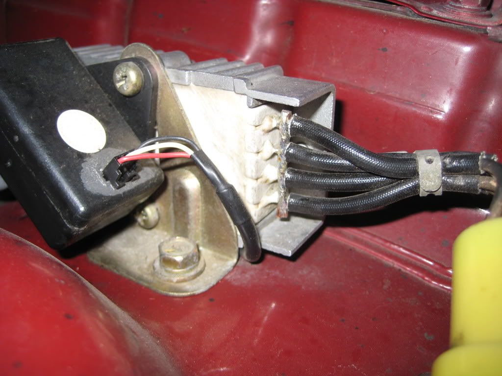

Hey sm im looking to remove my resistor box due to my new injectors and not sure on how to do so, iv done research but haven't found much for 7m just a bunch of hondas saying cut and put all the wires together, is it the same for my car just cut the 4 wires and just connect all 4 together and take resistor box out? any help would be great thanks guys, also pictures of anyone who has done this would be great as well thanks everyone.

supraguy@aol;1736200 said:
Clarification- What type of injectors are you putting in- and what year is your car- '88?
its a 1990 and 550cc high impedance Denso injectors
---------- Post added at 05:41 PM ---------- Previous post was at 05:41 PM ----------
jetjock;1736206 said:
The answer is yes, connect the wires together.
so just take the 4 wires on the harness and put it together , that easy?

I mean rather than cut the connector off the harness cut the wires off the resistor box and tie them together. Course, that'll make the box junk. It's six of one half dozen of the other. Me, I'd buy a new connector with pins and wire it so I could go back but something tells me you're not going to do that...

He means either you will destroy your car harness or destroy the harness for the box. A box with no connectors is junk but a wiring harness that is cut is not a good thing to have. But you can get a spare box on here for cheep so get one cut it and keep the spare.
