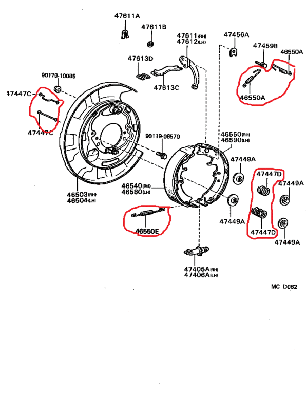

Man i wish some aftermarket company made these...Yes i did get all 4 shoes. You think i can get away from just buying these from toyota circled in red? or which else should i get?
Just for those parts circled are 38.30 in my local dealer

Get 47611 the horse shoe clip at the top.
The pins on the left you don't need unless there messed up.

you mean 47611A right? Anything else I'm missing? How difficult is it to replace the shoes? ( I have never done these type of brakes before)

15$ on average a parking brake hardware kit from local parts stores. from what i can tell you get all of the stuff in the picture as well
